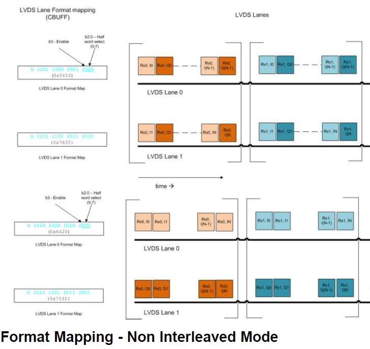

Currently I am streaming raw ADC data over two LVDS lanes.
There is some confusion on my side concerning the data format in non-interleaved mode.
Referring to the Data Path User Guide there are two modes for the LVDS lane format mapping (Figure21)
http://www.ti.com/lit/an/swra555/swra555.pdf
Searching in the Radar Interface Control Document all I could find was 5.16.6 Sub block 0x4045 – AWR_DEV_LVDS_CFG_SET_SB
Here the format map does only seem to switch lanes but not I/Q as in SWRA555.
Any ideas how to identify the data format?

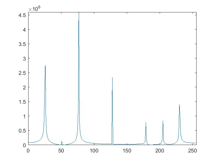

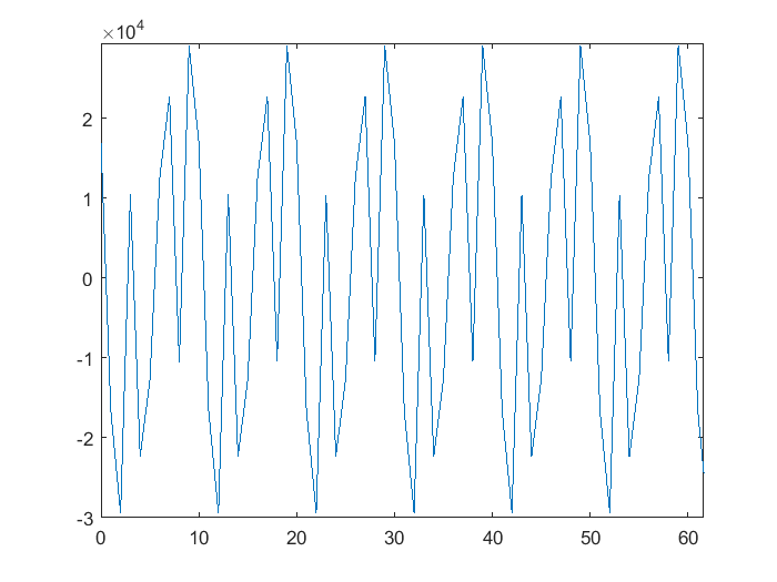

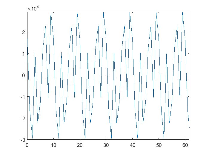

  • Thank you for your reply Cesar.
    Using the Matlab code for the AWR1642 I am plotting time and frequency domain over one chirp.
    Data was captured with the DCA1000 - I shoud have mentioned before.
    With SetTestSource in mmWave Studio I wanted to verify the PacketReorderZeroFill function from a lua script.
    The output from raw data read is a matrix of [numRx X numSamples*numChirps] complex.
    Starting simple - only absolute values are plotted.
    I expected a smooth sinusodial in time and a distinct peak in frequency domain.
    My results are below.. How can I interpret this?
    Is the DCA1k is sending LVDS data (over Ethernet) in a different manner than described in Figure 12 of SWRA581 since the Matlab code is written for TSW16xx?
    The lua function PacketReorderZeroFill  from mmWave studio should be filtering out Ethernet headers right?

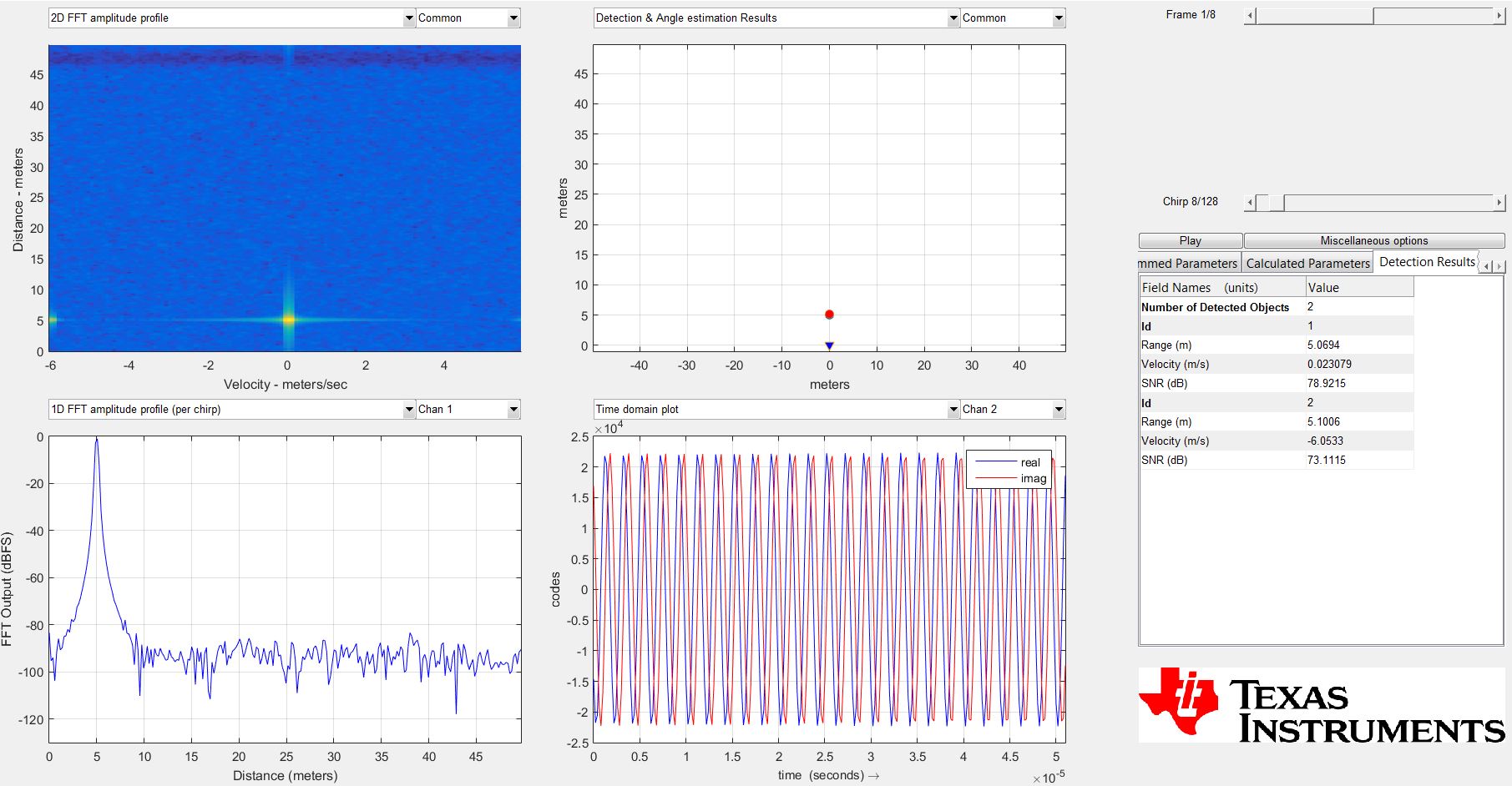

  • Hi Adrian,
    the Matlab Post Proc works just fine.
    Until now I was sending CLI commands over Demo Visualizer and recording with the software screenshotted below.

  • Thank you Adrian.
    Chapter 22 'Format of the raw captured file' section 8./9. for the AWR1642 solved the issue.
    The data format was already signed int16 - not uint16
    The attached Matlab script can reorder real and complex .bin files for further processing.
