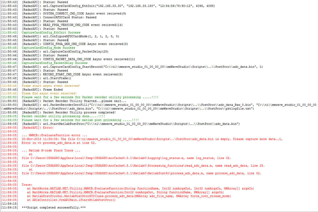

adc_data.bin is empty!

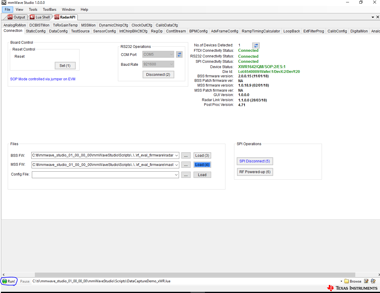

I am usind the DCA1000EVM to capture raw data from IWR1642BOOST (ES1). In the mmWave Studio, I am always facing a problem when  I push the run  button.
Actually, everything was successfully configured, but when it come to the PostProc, I face this issue:
MWMCR::EvaluateFunction error ...
The file C:\ti\mmwave_studio_01_00_00_00\mmWaveStudio\Scripts\..\PostProc\adc_data.bin is empty. Please capture more data.,1,
Error in => process_adc_data.m at line 52
Trace:
at MathWorks.MATLAB.NET.Utility.MWMCR.EvaluateFunction(String functionName, Int32 numArgsOut, Int32 numArgsIn, MWArray[] argsIn)
do any one have an idea how to solve this issue ??  (MCR is installed with the right version and reinstalled again to be sure.)
IWR board has SOP0 and SOP1 jumpers on.
thanks in advance,
Saleh
  • I should mention that previously it was working correctly . I have doubt if I should change some button on the DCA1000 board
  • Saleh,
    I see that your save location includes "\\..\\" replace those with your exact location. Example : C:\ti\mmwave_studio_02_00_00_02\mmWaveStudio\PostProc\adc_data.bin should be C:\\ti\\mmwave_studio_02_00_00_02\\mmWaveStudio\\PostProc\\adc_data.bin
    After Trigger Frame, look in folder location ~/mmwave_studio_<version>/mmWaveStudio/PostProc, the file "adc_data_Raw_0.bin" should have some data, if it has data then press the "PostProc" it will generate "adc_data.bin" and you should see the graphs.
    Let me know if this helps.
    Alex
