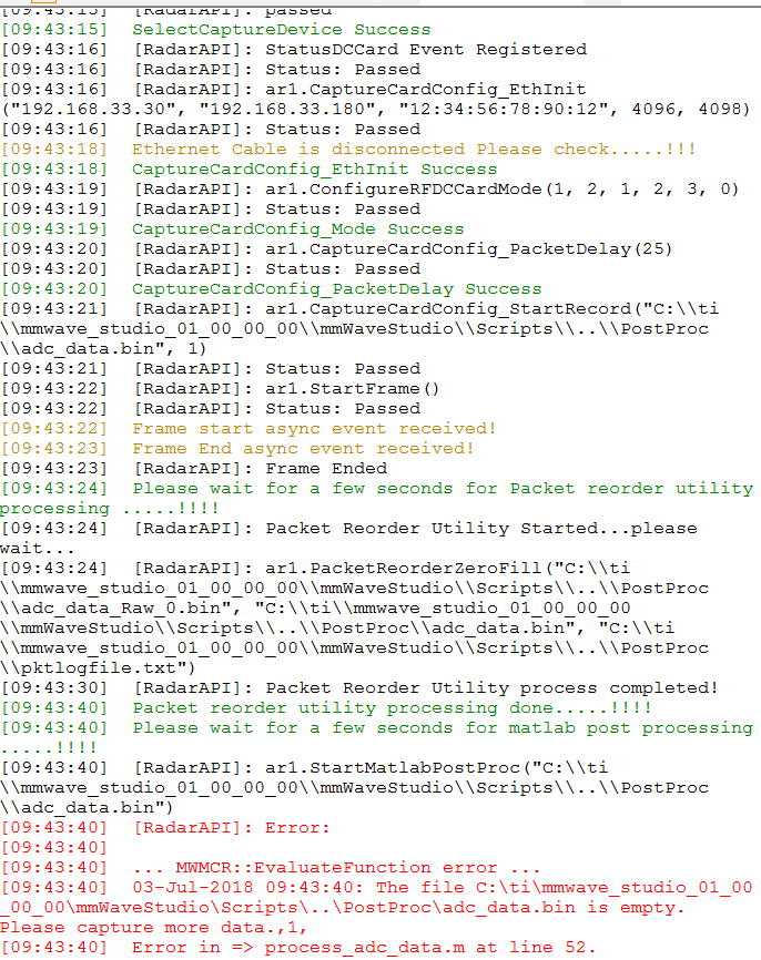

I am usind the DCA1000EVM to capture raw data from AWR1642BOOST. In ht emmWave Studio, I am always facing a problem when running the DataCaptureDemo.
Actually, everything was successfully configured, but when it come to the PostProc, I face this issue:
MWMCR::EvaluateFunction error ...
The file C:\ti\mmwave_studio_01_00_00_00\mmWaveStudio\Scripts\..\PostProc\adc_data.bin is empty. Please capture more data.,1,
Error in => process_adc_data.m at line 52
Trace:
at MathWorks.MATLAB.NET.Utility.MWMCR.EvaluateFunction(String functionName, Int32 numArgsOut, Int32 numArgsIn, MWArray[] argsIn)
do any one have an idea how to solve this issue ??  (MCR is installed with the right version and reinstalled again to be sure.)

    everything goes well till the PostProc step.
  • Just to make sure, all radar configuration steps before connecting with DCA1000 have been good without error?
    The error is saying that adc_data.bin is empty. Do you have adc_data.bin in PostProc folder? it should be 4096KB.
    You were using script of DataCaptureDemo_xWR.lua right? You pressed "setup" and config UART before running the script?
    Have you tried manually step through? Refer to the user guide and just follow the blue button and press through the tabs.

  • Hi Michelle,
    yes I followed the guide and do all the steps, I am running the demo (not step by step by my self). I have even tried it manually following the guide and i face the same problem. (everything is well set up).
    I do have the adc_data.bin file but always empty.

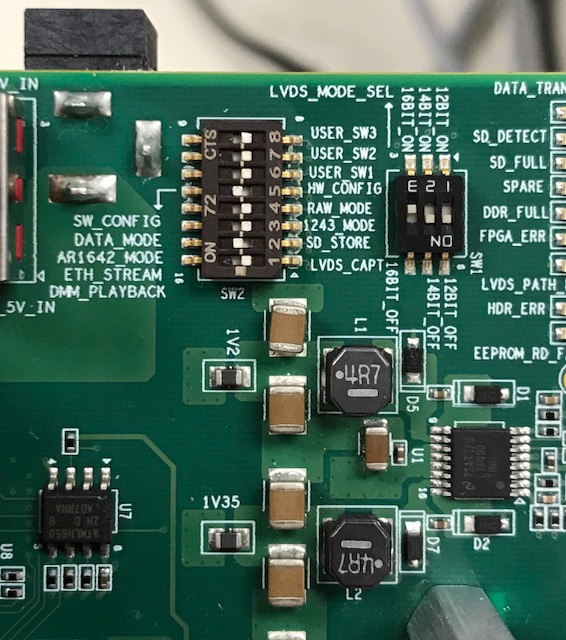

  • Does adc_data.bin saved with updated time stamp each time but with size 0? or it was from some other record. It'll help if it's deleted before recording.
    I also attached the switch setting of the DCA1000 just to compare.
    Make sure IWR board has SOP0 and SOP1 jumpers on.
    If still not working, I suggest to re-program FPGA image.
    Let me know how it works. Note, I'll be on vacation for the next 3 days so response will be delayed.
    Michelle
  • Hi Michelle,
    I have exactly the same configuration in my DCA1000, and I delete the old adc_data.bin before starting again.
    I am not using an IWR board, I'm using the AWR1642BOOST board with the DCA1000 card. both jumpers (SOP1 and SOP0) are on.
    Actually, I re-programmed the FPGA image before and faced the same problem.
    could it be a MCR version problem ? I installed the required one already.

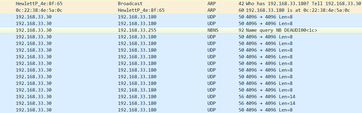

  • Hi Michelle,
    please find attached both Config and log files (1: for the laptop in which the data is well saved on disk, 2: for laptop in which data could not be saved on disk).
    I have also used Wireshark to track the issue, the DCA1000 is not sending UDP packets through Ethernet connection once start recording( for Win7 laptop) while the Win10 laptop, it is sending and I can see it.
    thanks in advance,
    Ahmed

    [15:01:58]  [RadarAPI]: Status: Passed
    [15:01:58]  LVDSLaneConfig Success
    [15:01:59]  [RadarAPI]: ar1.ProfileConfig(0, 77, 100, 6, 60, 0, 0, 0, 0, 0, 0, 29,982, 0, 256, 5000, 0, 0, 30)
    [15:01:59]  [RadarAPI]: Status: Passed
    [15:01:59]  ProfileConfig Success
    [15:02:00]  [RadarAPI]: ar1.ChirpConfig(0, 0, 0, 0, 0, 0, 0, 1, 0, 0)
    [15:02:00]  [RadarAPI]: Status: Passed
    [15:02:00]  ChirpConfig Success
    [15:02:01]  [RadarAPI]: ar1.DisableTestSource(0)
    [15:02:01]  [RadarAPI]: Status: Passed
    [15:02:02]  [RadarAPI]: ar1.FrameConfig(0, 0, 0, 64, 50, 0, 1)
    [15:02:02]  [RadarAPI]: Status: Passed
    [15:02:02]  FrameConfig Success
    [15:02:03]  [RadarAPI]: ar1.SelectCaptureDevice("DCA1000")
    [15:02:03]  [RadarAPI]: passed
    [15:02:03]  SelectCaptureDevice Success
    [15:02:04]  [RadarAPI]: StatusDCCard Event Registered
    [15:02:04]  [RadarAPI]: Status: Passed
    [15:02:04]  [RadarAPI]: ar1.CaptureCardConfig_EthInit("192.168.33.30", "192.168.33.180", "12:34:56:78:90:12", 4096, 4098)
    [15:02:04]  [RadarAPI]: SYSTEM_CONNECT_CMD_CODE Async event recieved(9)
    [15:02:04]  [RadarAPI]: ConnectRFDCCard Status: Passed
    [15:02:04]  [RadarAPI]: READ_FPGA_VERSION_CMD_CODE event recieved(14)
    [15:02:04]  CaptureCardConfig_EthInit Success
    [15:02:05]  [RadarAPI]: ar1.ConfigureRFDCCardMode(1, 2, 1, 2, 3, 0)
    [15:02:05]  [RadarAPI]: Status: Passed
    [15:02:05]  [RadarAPI]: CONFIG_FPGA_GEN_CMD_CODE Async event recieved(3)
    [15:02:05]  CaptureCardConfig_Mode Success
    [15:02:06]  [RadarAPI]: ar1.CaptureCardConfig_PacketDelay(25)
    [15:02:06]  [RadarAPI]: Status: Passed
    [15:02:06]  [RadarAPI]: CONFIG_PACKET_DATA_CMD_CODE Async event recieved(11)
    [15:02:06]  CaptureCardConfig_PacketDelay Success
    [15:02:07]  [RadarAPI]: ar1.CaptureCardConfig_StartRecord("C:\\TI\\mmwave_studio_01_00_00_00\\mmWaveStudio\\Scripts\\..\\PostProc\\adc_data.bin", 1)
    [15:02:07]  [RadarAPI]: Status: Passed
    [15:02:07]  [RadarAPI]: RECORD_START_CMD_CODE Async event recieved(5)
    [15:02:10]
    [15:02:10]  ***Script completed successfully.***
    [15:02:37]  [RadarAPI]: STS_NO_LVDS_DATA Async event recieved(0)
    [15:04:06]  [RadarAPI]: ar1.PowerOff()
    [15:04:06]  [RadarAPI]: Status: Passed
    [15:04:06]  [RadarAPI]: ar1.SaveSettings('C:\Users\asus\AppData\Roaming\RSTD\ar1gui.ini')
    [15:04:06]  [RadarAPI]: Opening Gpio Control Port()
    [15:04:06]  [RadarAPI]: ar1.Disconnect()
    [15:04:06]  [RadarAPI]: ar1.Calling_ATE_DisconnectTarget()
    [15:04:06]  [RadarAPI]: ar1.Calling_IsConnected()
    [15:04:07]  [RadarAPI]: Opening Board Control Port()
    [15:04:07]  [RadarAPI]: Status: Passed
    [15:04:07]  [RadarAPI]: ar1.Connect(9,921600,1000)
    [15:04:08]  [RadarAPI]: ar1.FullReset()
    [15:04:08]  [RadarAPI]: Status: Passed
    [15:04:08]  [RadarAPI]: Closing Board Control Port()
    [15:04:08]  [RadarAPI]: Closing Gpio Control Port()
    [15:04:08]  [RadarAPI]: ar1.SOPControl(2)
    [15:04:10]  [RadarAPI]: Warning: Connected with baudrate 115200
    [15:04:11]  [RadarAPI]: Warning: Disconnected existing BaudRate
    [15:04:11]  [RadarAPI]: Warning: Trying to connect with baudrate 921600
    [15:04:13]  [RadarAPI]: ar1.Calling_IsConnected()
    [15:04:14]  [RadarAPI]: ar1.SelectChipVersion("XWR1642")
    [15:04:14]  [RadarAPI]: Status: Passed
    [15:04:15]  [RadarAPI]: ar1.SelectChipVersion("XWR1642")
    [15:04:15]  [RadarAPI]: Status: Passed
    [15:04:15]  [RadarAPI]: ar1.SaveSettings('C:\Users\asus\AppData\Roaming\RSTD\ar1gui.ini')
    [15:04:16]  [RadarAPI]: ar1.ReadRegister(0xffffe210, 0, 31)
    [15:04:16]  [RadarAPI]: Value : 300002
    [15:04:16]  [RadarAPI]: ar1.ReadRegister(0xffffe218, 0, 31)
    [15:04:16]  [RadarAPI]: Value : 1
    [15:04:16]  [RadarAPI]: ar1.DownloadBSSFw("C:\\TI\\mmwave_studio_01_00_00_00\\mmWaveStudio\\Scripts\\..\\..\\rf_eval_firmware\\radarss\\xwr16xx_radarss_rprc_ES1.0.bin")
    [15:04:17]  [RadarAPI]: Downloading BSS ROM RPRC Binary..
    [15:04:23]  BSS FW Download Success
    [15:04:25]  [RadarAPI]: ar1.DownloadMSSFw("C:\\TI\\mmwave_studio_01_00_00_00\\mmWaveStudio\\Scripts\\..\\..\\rf_eval_firmware\\masterss\\xwr16xx_masterss_rprc_ES1.0.bin")
    [15:04:25]  [RadarAPI]: Downloading MSS RPRC Binary..
    [15:04:29]  MSS FW Download Success
    [15:04:31]  MSS power up done async event received!
    [15:04:31]  [RadarAPI]: ar1.PowerOn(0, 1000, 0, 0)
    [15:04:31]  [RadarAPI]: Status: Passed
    [15:04:31]  [RadarAPI]: ar1.SaveSettings('C:\Users\asus\AppData\Roaming\RSTD\ar1gui.ini')
    [15:04:31]  Power On Success
    [15:04:32]  BSS power up done async event received!
    [15:04:32]  [RadarAPI]: ar1.RfEnable()
    [15:04:32]  [RadarAPI]: Status: Passed
    [15:04:33]  RF Enable Success
    [15:04:34]  [RadarAPI]: ar1.ChanNAdcConfig(1, 0, 0, 1, 1, 1, 1, 2, 1, 0)
    [15:04:34]  [RadarAPI]: Status: Passed
    [15:04:34]  ChanNAdcConfig Success
    [15:04:35]  [RadarAPI]: ar1.LPModConfig(0, 1)
    [15:04:36]  [RadarAPI]: Status: Passed
    [15:04:36]  LPModConfig Success
    [15:04:38]  [RadarAPI]: ar1.RfInit()
    [15:04:38]  RF Init async event received!
    [15:04:38]  [RadarAPI]: Time stamp, Temperture: 5400,45; APLL Status, Update: 1, 0; SynthVCO1 Status, Update: 1, 1; SynthVCO2 Status, Update: 1, 1; LODist Status, Update: 1, 1; RxADCDC Status, Update: 1, 1; HPFcutoff Status, Update: 1, 1; LPFcutoff Status, Update: 1, 1; PeakDetector Status, Update: 1, 1; TxPower Status, Update: 1, 1; RxGain Status, Update: 1, 1; RxIQMM Status, Update: 1, 1;
    [15:04:38]  [RadarAPI]: Status: Passed
    [15:04:38]  RfInit Success
    [15:04:39]  [RadarAPI]: ar1.DataPathConfig(1, 1, 0)
    [15:04:39]  [RadarAPI]: Status: Passed
    [15:04:39]  DataPathConfig Success
    [15:04:40]  [RadarAPI]: ar1.LvdsClkConfig(1, 1)
    [15:04:40]  [RadarAPI]: Status: Passed
    [15:04:40]  LvdsClkConfig Success
    [15:04:41]  [RadarAPI]: ar1.LVDSLaneConfig(0, 1, 1, 0, 0, 1, 0, 0)
    [15:04:41]  [RadarAPI]: Status: Passed
    [15:04:41]  LVDSLaneConfig Success
    [15:04:42]  [RadarAPI]: ar1.ProfileConfig(0, 77, 100, 6, 60, 0, 0, 0, 0, 0, 0, 29,982, 0, 256, 5000, 0, 0, 30)
    [15:04:42]  [RadarAPI]: Status: Passed
    [15:04:42]  ProfileConfig Success
    [15:04:43]  [RadarAPI]: ar1.ChirpConfig(0, 0, 0, 0, 0, 0, 0, 1, 0, 0)
    [15:04:43]  [RadarAPI]: Status: Passed
    [15:04:43]  ChirpConfig Success
    [15:04:44]  [RadarAPI]: ar1.DisableTestSource(0)
    [15:04:44]  [RadarAPI]: Status: Passed
    [15:04:44]  [RadarAPI]: ar1.FrameConfig(0, 0, 10, 64, 50, 0, 1)
    [15:04:44]  FrameConfig Success
    [15:04:45]  [RadarAPI]: ar1.SelectCaptureDevice("DCA1000")
    [15:04:45]  [RadarAPI]: passed
    [15:04:45]  SelectCaptureDevice Success
    [15:04:46]  [RadarAPI]: StatusDCCard Event Registered
    [15:04:46]  [RadarAPI]: Status: Passed
    [15:04:46]  [RadarAPI]: ar1.CaptureCardConfig_EthInit("192.168.33.30", "192.168.33.180", "12:34:56:78:90:12", 4096, 4098)
    [15:04:46]  [RadarAPI]: SYSTEM_CONNECT_CMD_CODE Async event recieved(9)
    [15:04:46]  [RadarAPI]: ConnectRFDCCard Status: Passed
    [15:04:46]  [RadarAPI]: READ_FPGA_VERSION_CMD_CODE event recieved(14)
    [15:04:46]  CaptureCardConfig_EthInit Success
    [15:04:47]  [RadarAPI]: ar1.ConfigureRFDCCardMode(1, 2, 1, 2, 3, 0)
    [15:04:47]  [RadarAPI]: Status: Passed
    [15:04:47]  [RadarAPI]: CONFIG_FPGA_GEN_CMD_CODE Async event recieved(3)
    [15:04:47]  CaptureCardConfig_Mode Success
    [15:04:48]  [RadarAPI]: ar1.CaptureCardConfig_PacketDelay(25)
    [15:04:48]  [RadarAPI]: Status: Passed
    [15:04:48]  [RadarAPI]: CONFIG_PACKET_DATA_CMD_CODE Async event recieved(11)
    [15:04:48]  CaptureCardConfig_PacketDelay Success
    [15:04:49]  [RadarAPI]: ar1.CaptureCardConfig_StartRecord("C:\\TI\\mmwave_studio_01_00_00_00\\mmWaveStudio\\Scripts\\..\\PostProc\\adc_data.bin", 1)
    [15:04:49]  [RadarAPI]: Status: Passed
    [15:04:49]  [RadarAPI]: RECORD_START_CMD_CODE Async event recieved(5)
    [15:04:52]  [RadarAPI]: ar1.StartFrame()
    [15:04:52]  [RadarAPI]: Status: Passed
    [15:04:52]  Frame start async event received!
    [15:04:52]  Frame End async event received!
    [15:04:52]  [RadarAPI]: Frame Ended
    [15:04:54]  [RadarAPI]: STS_RECORD_COMPLETED Async event recieved(8)
    [15:04:54]  [RadarAPI]: ar1.CaptureCardConfig_StopRecord()
    [15:04:54]  [RadarAPI]: Status: Passed
    [15:04:54]  [RadarAPI]: RECORD_STOP_CMD_CODE Async event recieved(6)
    [15:04:57]  Please wait for a few seconds for Packet reorder utility processing .....!!!!
    [15:04:57]  [RadarAPI]: Packet Reorder Utility Started...please wait...
    [15:04:57]  [RadarAPI]: ar1.PacketReorderZeroFill("C:\\TI\\mmwave_studio_01_00_00_00\\mmWaveStudio\\Scripts\\..\\PostProc\\adc_data_Raw_0.bin", "C:\\TI\\mmwave_studio_01_00_00_00\\mmWaveStudio\\Scripts\\..\\PostProc\\adc_data.bin", "C:\\TI\\mmwave_studio_01_00_00_00\\mmWaveStudio\\Scripts\\..\\PostProc\\pktlogfile.txt")
    [15:05:02]  [RadarAPI]: Packet Reorder Utility process completed!
    [15:05:02]  Reordering required : NO
    [15:05:02]  Packet loss : NO
    [15:05:02]  Number of packets received : 1801
    [15:05:02]  Number of zero filled packets : 0
    [15:05:02]  Number of zero filled bytes : 0
    [15:05:22]  Packet reorder utility processing done.....!!!!
    [15:05:22]  [RadarAPI]: ar1.StartMatlabPostProc("C:\\TI\\mmwave_studio_01_00_00_00\\mmWaveStudio\\Scripts\\..\\PostProc\\adc_data.bin")
    [15:05:42]
    [15:05:42]  ***Script completed successfully.***

    [15:13:03]  [RadarAPI]: ar1.SelectCaptureDevice("DCA1000")
    [15:13:03]  [RadarAPI]: passed
    [15:13:03]  SelectCaptureDevice Success
    [15:13:04]  [RadarAPI]: StatusDCCard Event Registered
    [15:13:04]  [RadarAPI]: Status: Passed
    [15:13:04]  [RadarAPI]: ar1.CaptureCardConfig_EthInit("192.168.33.30", "192.168.33.180", "12:34:56:78:90:12", 4096, 4098)
    [15:13:06]  Ethernet Cable is disconnected Please check.....!!!
    [15:13:06]  CaptureCardConfig_EthInit Success
    [15:13:07]  [RadarAPI]: ar1.ConfigureRFDCCardMode(1, 2, 1, 2, 3, 0)
    [15:13:07]  [RadarAPI]: Status: Passed
    [15:13:07]  CaptureCardConfig_Mode Success
    [15:13:08]  [RadarAPI]: ar1.CaptureCardConfig_PacketDelay(25)
    [15:13:08]  [RadarAPI]: Status: Passed
    [15:13:08]  CaptureCardConfig_PacketDelay Success
    [15:13:09]  [RadarAPI]: ar1.CaptureCardConfig_StartRecord("C:\\ti\\mmwave_studio_01_00_00_00\\mmWaveStudio\\Scripts\\..\\PostProc\\adc_data.bin", 1)
    [15:13:09]  [RadarAPI]: Status: Passed
    [15:13:13]  [RadarAPI]: ar1.StartFrame()
    [15:13:13]  [RadarAPI]: Status: Passed
    [15:13:13]  Frame start async event received!
    [15:13:14]  Frame End async event received!
    [15:13:14]  [RadarAPI]: Frame Ended
    [15:13:17]  Please wait for a few seconds for Packet reorder utility processing .....!!!!
    [15:13:17]  [RadarAPI]: Packet Reorder Utility Started...please wait...
    [15:13:17]  [RadarAPI]: ar1.PacketReorderZeroFill("C:\\ti\\mmwave_studio_01_00_00_00\\mmWaveStudio\\Scripts\\..\\PostProc\\adc_data_Raw_0.bin", "C:\\ti\\mmwave_studio_01_00_00_00\\mmWaveStudio\\Scripts\\..\\PostProc\\adc_data.bin", "C:\\ti\\mmwave_studio_01_00_00_00\\mmWaveStudio\\Scripts\\..\\PostProc\\pktlogfile.txt")
    [15:13:22]  [RadarAPI]: Packet Reorder Utility process completed!
    [15:13:26]  Packet reorder utility processing done.....!!!!
    [15:13:26]  [RadarAPI]: ar1.StartMatlabPostProc("C:\\ti\\mmwave_studio_01_00_00_00\\mmWaveStudio\\Scripts\\..\\PostProc\\adc_data.bin")
    [15:13:27]  [RadarAPI]: Error:
    [15:13:27]
    [15:13:27]  ... MWMCR::EvaluateFunction error ...
    [15:13:27]  23-Jul-2018 15:13:27: The file C:\ti\mmwave_studio_01_00_00_00\mmWaveStudio\Scripts\..\PostProc\adc_data.bin is empty. Please capture more data.,1,
    [15:13:27]  Error in => process_adc_data.m at line 52.
    [15:13:27]
    [15:13:27]  ... Matlab M-code Stack Trace ...
    [15:13:27]      at
    [15:13:27]  file C:\Users\G5T2WGB\AppData\Local\Temp\G5T2WGB\mcrCache8.5.1\Matlab0\Logging\log_status.m, name log_status, line 32.
    [15:13:27]      at
    [15:13:27]  file C:\Users\G5T2WGB\AppData\Local\Temp\G5T2WGB\mcrCache8.5.1\Matlab0\Processing_functions\read_adc_data.m, name read_adc_data, line 28.
    [15:13:27]      at
    [15:13:27]  file C:\Users\G5T2WGB\AppData\Local\Temp\G5T2WGB\mcrCache8.5.1\Matlab0\MatlabPostPr\process_adc_data.m, name process_adc_data, line 52.
    [15:13:27]
    [15:13:27]
    [15:13:27]  Trace:
    [15:13:27]     at MathWorks.MATLAB.NET.Utility.MWMCR.EvaluateFunction(String functionName, Int32 numArgsOut, Int32 numArgsIn, MWArray[] argsIn)
    [15:13:27]     at MathWorks.MATLAB.NET.Utility.MWMCR.EvaluateFunction(Int32 numArgsOut, String functionName, MWArray[] argsIn)
    [15:13:27]     at MatlabPostProcGui.MatlabPostProcGUIClass.process_adc_data(MWArray adc_file_name, MWArray force_cont_stream_mode)
    [15:13:27]     at AR1xController.frmAR1Main.iStartMtlabPostProc()
    [15:13:27]
    [15:13:27]  ***Script completed successfully.***

    I tried your conf2.xml and it works well on my PC (win7). Then I checked the log2.txt and found the following lines:
    It shows that DCA1000 Ethernet is not connected. Please make sure the connection is good.
    Michelle
    the DCA1000 is well connected and I can see received stream in the Etnernet interface (but not stored). I have also used Wireshark to track the packets send from each part, both parts exchange packets but when it comes to capture the signal, only the laptop is sending UDP packets, while the DCA1000 should also send UDP signal packets.
    thank you in advance,
    ahmed

  • Ahmed,
    To summarize the issue:
    DCA1000 and IWR1642BOOST setup, works for one PC, but not on the other. Correct?
    Assuming the same software are installed, then the question is what is different for the two PC?
    If there is an error saying no Ethernect connection, you might have a firewall or vpn blocking the data. There's firewall options under system of control panel where you can either disable fender firewall or enable the mmwave studio access through firewall.
    Thanks and Regards,
    Michelle
  • Hi Michelle,
    I have solved my problem, it was a firewall issue.
    thanks again,
    Ahmed
