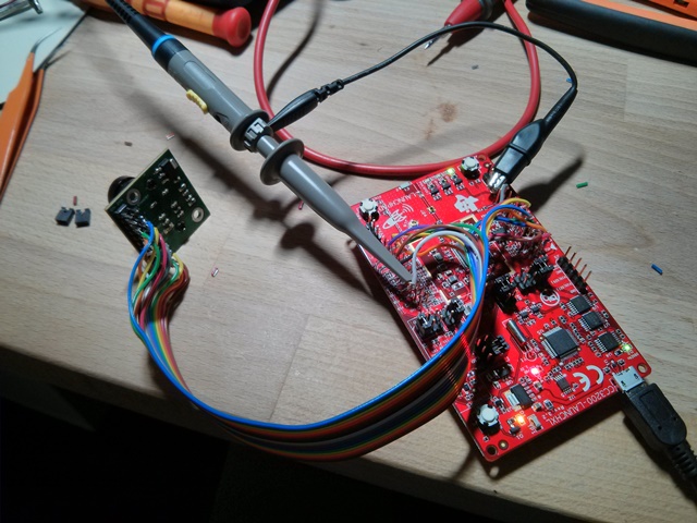

  • Hello Gagan,
    I was too impatient to wait, so I decided to hack together my own module.
    I simply used the same MT9D111 module that the booster pack is slated to use.
    Wiring the camera, going through the doc and loading the code got me fairly far.
    The webpage is being served with the default image, and I can see camera data flowing down the lines on the oscilloscope.
    This is however where I hit a snag.
    The webpage loads, and the camera data is clearly going into the chip (data lines seem good, clock and HSYNC, VSYNC all good, I2C config happens at boot).
    However, I never get the image out, the webpage just shows a null (blank) image when I click the button to grab an image.
    Is this a know problem? Is there a misconfig of some sort?
    I have attached images of the jumper configuration I have it currently running with.
    Thanks for the advice,
    Ilia Baranov

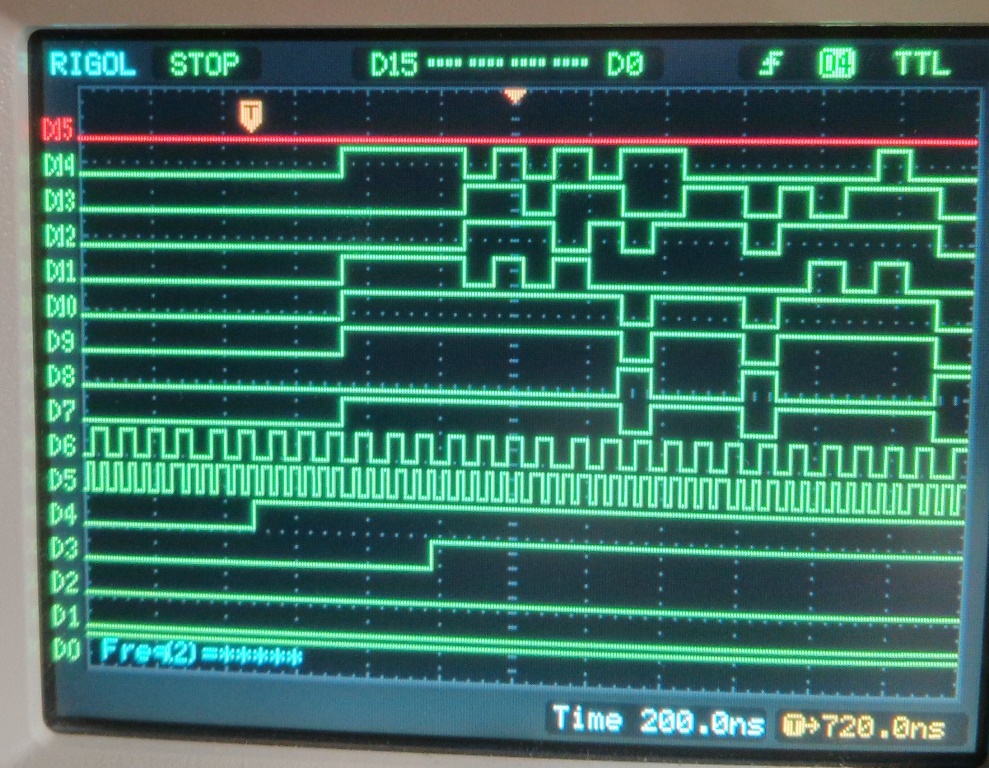

  • Hello again,
    I want to share some updates and comments on this.
    1. Using the Logic analyser, I can clearly see that camera outputs nothing on startup. It is then fed I2C commands, and begins to output data.
    2. This data all looks valid. In the following image we have:
    D3: HRef      D4: Vsync      D5: XCLK    D6: PCLK   D7-D14: 8bit data
    We can also see that Href and Vsync do what they should:
    I have loaded the included, pre-compiled example code via Uniflash. Settings are 8MBit capacity, non-secure, non-alert. Program starts up normally.
    At this point, I am unsure what could be wrong with simply displaying the image.

  • Hi Ilia, How has been your experience with the camera application with CC3200? I have a similar application but I see you have had several problems making the system work? Were you finally able to get everything working? Is it worth spending time/efforts if I am starting with something similar or should I invest time looking into alternatives? Would really appreciate your response. Thanks!
  • Hey,
    I was unable to get the camera I had to work, either through wiring issues or just software problems.
    I was suspecting some of the firmware wasn't quite right, as the oscilloscope showed good signals coming through.
    In general, unless you really need the small size and low cost of the CC3200, I would go with a Raspberry Pi + camera module.
