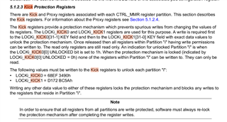

    In the meantime I was analyzing the J784S4's TRM document (SPRUJ52C – JUNE 2022 – REVISED JULY 2023) and the driver you suggested.
    Based on the documentation, we configured the ref clock to guarantee access to the user configuration (+information seen in Figure 12-119. PCIe subsystem block diagram).
    This analysis resulted in the following configuration to select core_refclk for torrent select MAIN_PLL2_HSDIV4_CLKOUT for 100 MHz in function CSL_serdesRefclkSel (location:ti-j784s4/pdk_j784s4_09_01_00_22/packages/ti/csl/src/ip/serdes_cd/V3/csl_serdes3.c). Within the functions used in this file, I confirmed the writing of the values ​​by reading them, to guarantee the correct W/R operations.
    With that in mind, can you confirm that the ref clock configuration is correct for configuring the serdes0 pcie1?

  • Hi Joao,
    Yes, MAIN_PLL2_HSDIV4_CLKOUT should be correct. From this, I assume you do not have an external clock generator to provide 100MHz, so you will need to enable ACSPCIe buffer to output PCIe refclk to connector like in this function: https://git.ti.com/cgit/ti-linux-kernel/ti-linux-kernel/tree/drivers/pci/controller/cadence/pci-j721e-host.c?h=ti-linux-6.1.y#n242
    Also, please check if CTRLMMR registers are actually being modified as these registers are protected by a LOCK_KICK register. Details in TRM:
    Takuma
  • Thank you Takuma,
    It's already solved. The offsets to write to the MMR registers were wrong. That's why the write operation to the blocks was always blocked.
    Thanks for the help.
