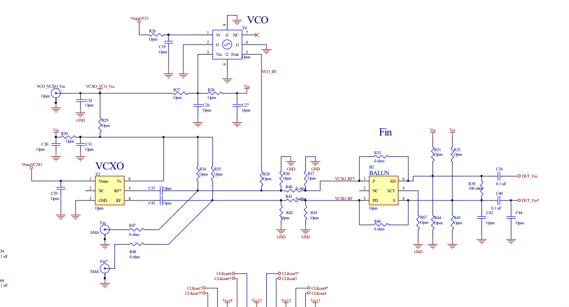

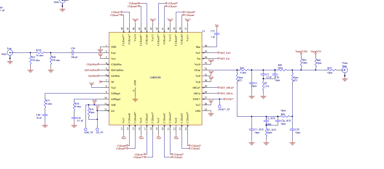

  • Dear Lane,
            Please help to confirm whether the DEMO you are using is the LMK03200EVAL model board, and whether the circuit part is completely consistent with this schematic diagram. If it is different, please help to point out different BOM materials so that we can modify the circuit to match yours. DEMO is consistent, thank you~

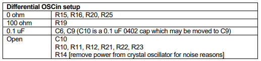

    Here is the measurement with increased resolution bandwidth. I'm only seeing one tone at 320MHz, this is likely an interference from nearby equipment in my lab.
    The following changes were made to the board in order to use a differential OSCin input. Also, the loop filter is changed, but I'm not sure exactly which values are on the board.
