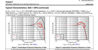

  • Tough requirement - consider
    1. THS3217 from DAC to single ended 10Vpp at gain of 10,
    Then a THS3491 for the rest of the gain - if you are not volume production, you might just try the THS3491 at higher supplies - we validated operation up through about 48V in characterization, but did not specify as the process limits would not in theory support that. And then, with this kind of 9V/nsec slew rate, if your load is capacitive you will be asking for large transition currents - check that and stability. The THS3491 is the highest slew rate, highest output current,  op amp out there, so see what you can get out of that. Good thermal design will be mandatory, use the QFN with the heat spreading plate connecte to large plane, it has a die temp sense output also you will want to monitor.

  • Thanks for the reply Michael, the 3217 looks like it could be very useful for a lot of the work we do. This chip and the 3491 seem like a killer combo for this application :)
    The load will be capacitive, I believe in the uF range but I will hopefully have an approximate value soon - would you be able to expand on what you mean by checking the transition currents and stability? I'd also be keen to read more on this if you have any good material in mind. Same goes for thermal design - I don't have much experience with designing around loads which are this demanding, so any additional advice is much appreciated!
