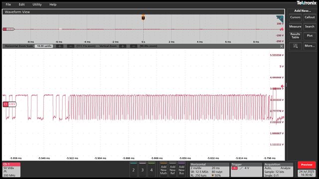

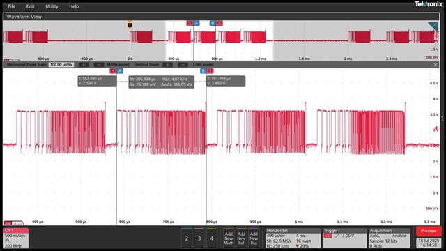

TMS320F28384D: Transmissions not observed when BRS is enabled.
Part Number: TMS320F28384D
Hey,
Similar to this question... I don't observe any transmissions (using a CAN FD Bus Analyzer) occurring between two nodes on my bus when I enable MCAN_TxBufElement.brs & MCAN_InitParams.brsEnable. My setup was working OK when MCAN_InitParams.brsEnable was 0 and MCAN_TxBufElement.brs was 1 but that means my data is also being transmitted at the speed of arbitration.
I was also checking the example code mcan_config_c28x with mcan_ex2_external_loopback in CM core, and my MCAN_CLK being 25 MHz. When I enable BRS in both MCAN_CCCR and in Tx Buffer Element, I get errors and the program stops at the error breakpoint for the most part but also at the Interrupt ISR error breakpoint a few times. Below is the code I'm working with for your reference:

    and also a few snapshots from the scope of CAN_H for your reference:
    First frame is from the main node requesting data and the consequent 4 frames are from the local node responding with data.
    All the frames with 64 bytes of data are about 200 microsec wide.
    I wanted to know if the disturbance/noise that you see there is too much (noise at the end of frame and the consistent noise below the axis).
    One other thing I wanted to ask is about TDC. Now that my prescaler is 1 (0+1) and DTSEG1 is 2 (1+1), what should my TDCO and TDCF be?
    I read in a thread here on the forum that both TDCO = TDCF = DTSEG1 (here, 2).
    All the captures above are with the default TDCO and TDCF from the example codes (TDCO = 0x6 and TDCF = 0xA). If there's any more data that you could use for your conclusion, please let me know.
    Nalin
  • Hi Nalin,
    Thanks for getting the overall plot but really hard to see or focus on the data phase when bitrate switched to 5Mbps.  Can you take a snap from where BRS starts up to where the ACK is received (the last bit that overshoots at the end of frame)?  May be tricky to locate the BRS bit especially if the scope does not have a CAN-FD decoding capability but just start the capture to a few cycles prior when the data periods start to shrink.  Data for one frame should be good.
    Joseph
  • Hi Joseph,
    Apologies for the late reply and also for the unclear images attached,
    This is the request frame with the ID A231.
    This is the response frame with the ID 1A31 (in response to Master unit's request A131) with the same configuration as the above structure.
    The frame is a little skewed because I hadn't connected this control card's Isolated Ground to the scope when I captured.
    This is a zoomed-in capture. I hadn't noted down what the ID for this is but the configuration is the same as the two above.
    I also changed my RXFIFO1 size because there was a mismatch in the number of frames received in the main unit but it has been fixed now.
    I appreciate your time and feedback regarding my issue over the past month or so, Joseph. Thank you very much! It appears I have the system running as per my teams constraints. I'm OK with closing this thread.
    Nalin
