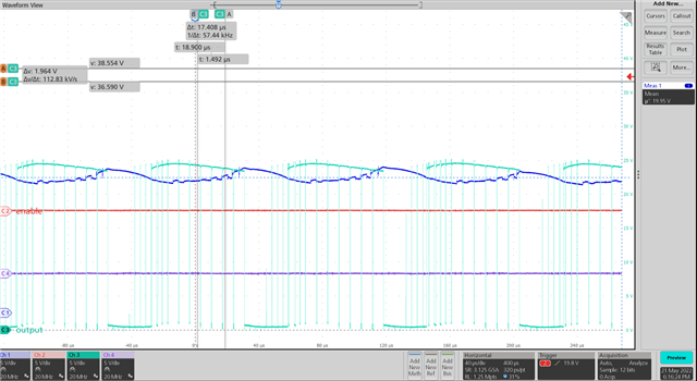

my customer discover some  problem under 24 to 20V step down conversion
the load is 5A.
channel 1 is vout, channel 3 is SW,
you can see the PWM doesn't follow FCCM behavior,
May I know is this slope compensation problem or something else?
below is the schematic, they basically follow this file EPR_EVME3(001)_Sch_Dell.PDF
I try webench to emulate it but the phase margin looks fine, so weird...

    3. there's a strange thing happen, like I said they discover abnormal PWM behavior in every PD possible output with Rc1=2.4k and Cc1=27nF.
    but when they change to Rc1=10k, Cc1=270pF, it somehow work stable again,
    but the bode plot looks failed to me in the calculator. and decreasing the RC of compensation is supposed to be worse since it push the zero farther,
     how did it happen?

  • Hi Fred, there is always some difference between the mathematical model (e.g. done with the Excel, or other tool) and the real hardware as all the board and components parasitics can not be considered. To get the right value a measurement on the board with a vector network analyzer would be required.
    Not sure what Steve will recommend here but i would be really go to measure the real loop compensation performance on the board.
    There is also a very low Slope compensation capacitor used. You might try to increase this to e.g. 470pF to avoid a too high slope compensation.
     Stefan

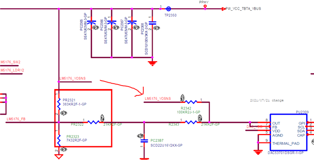

  • Hi Stefan, Steve,
    they connect VOSNS  directly to DAC output, I don't see the meaning why ?
    is this making extra pole or zero at FB pin that potentially causing instability?
  • Hi Fred,
    R2342 should not be assembled on the Board. Having this resistor in does not work.
     Stefan

  • Stefan,
    The purpose of R2342 is to ensure that if the DCDC is enabled before the DAC is configured that the output voltage is limited to about 12V.
    Without this resistor if the DCDC is enabled and the DAC is not configured then the output voltage will go to its maximum value (50V in my case).
    This is because the DAC is a voltage DAC that powers up with a floating output. Once the DAC is enabled it will effectively over-drive R2342 hence effectively remove it from the current steering.
  • Fred,
    The purpose of capacitor PC2387 is to limit the slew rate on a voltage change. Without this capacitor a step change in the DAC output will cause a VERY fast step change in the output voltage (violating the spec).
    This does not create any poles etc... since it is not in the dynamic control loop. It is really only filtering the DAC output.
    Steve

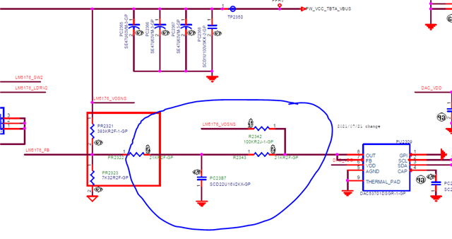

  • Hi Steven,
    I appreciate your explanation ,
    but would you elaborate on the dynamic control loop part?
    since the path from Vout to VFB did pass several R and C, not to mentioned the vout is directly connect to DAC,
    so I guess this definitely introduce unexpected pole, please correct  me if I'm wrong , thanks

  • Fred,
    I am not a control loop expert so you will need to do a Bode analysis if you want/need it.
    VOut is not really directly connected to the DAC, but as you say the loop does have capacitors and resistors. The "direct connection" through R2342 becomes irrelevant once the DAC is enabled since both sides are very low impedance compared to the resistor value, hence dominate. The capacitor is really no different to typical DCDC configurations where a capacitor can be placed on the FB pin to reduce the effects of load transitions and/or increase response (when on the high side). I agree that the stability needs to be checked, but it is a fairly common practice.
    If you want to remove the filter capacitor then you can, but you will then need to make sure that there is not a step change in the DAC output.
    Basically, all I can really comment is that this implementation works for me in my scenario. My specific design was not intended to be guaranteed to be stable across all conditions nor used as a verified customer solution. It was for an internal development of other features of our project to provide a variable 3V to 50V supply.
  • Hi Steven,
    thanks and
    no offense,  just trying to find the root cause for the customers, I'll do the bode plot analysis on the board if needed,
    but like you said normally we add capacitor at high side of FB resistor to help transient, but not sure if the low side in this case has any side effect or not.

  • Hi Fred,
    i would like to follow up on and point which was discussed somewhere above but I have not seen an updated on that:
    "There is also a very low Slope compensation capacitor used. You might try to increase this to e.g. 470pF to avoid a too high slope compensation."
     Stefan
