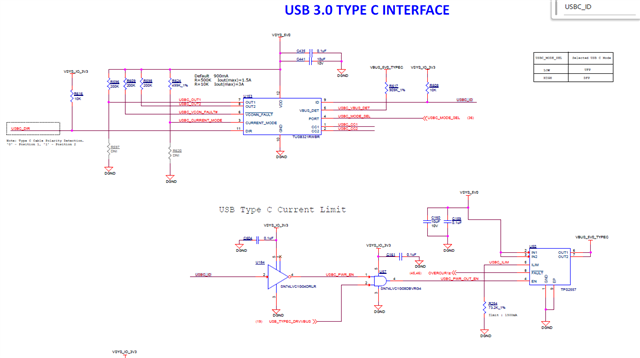

14. Do you have some recommendations on the Type-C implementation.
15. Can I use 3.4K instead of 3.5K.

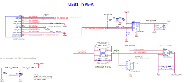

    USB0 interface supports Host or Device or Dual-Role (DRD)
    1. Is the VBUS connection required for Host configuration or Device configuration.
    VBUS connection for Host interface is optional.
    It is recommended to connect the VBUS when the USB interface is configured as Device.
    The recommended voltage range is the divided voltage equivalent of 4.75 V - 5.25 V for normal operation.
    1. Can I have the VBUS supply input connected when the SoC power supply is switched off
    USB VBUS IO is fail-safe. The VBUS input does not have any dependency on the SOC power supply.
    1. Is there a power sequencing requirement for VBUS input.
    USB VBUS IO is fail-safe and do not have any sequencing requirements.
    1. Can I connect 5 V input from the USB connector directly to VBUS input.
    VBUS pin cannot be connected directly to external/connector VBUS, as IO is not 5 V compliant. Recommend using voltage divider and/or current limiter to ensure IO requirements are met. VBUS pin can be consider fail-safe only if recommended external divider circuit is used.
    Connection of 3.3 V directly to VBUS input is not allowed or recommended.
    For USB Device interface, it is recommended to connect a switched external USB VBUS supply to the USB0_VBUS input of the SOC through recommended resistor divider.
    1. Recommended VBUS supply voltage divider
    Refer section 9.2.3 USB VBUS Design Guidelines of the data sheet.

    1. Do you have some recommendations on the Type-C implementation.
      AM64x EVM or SK does not have the implementation.
      Refer below starter kit for implementation.
      https://www.ti.com/tool/SK-AM62B-P1
    2. VBUS voltage divider use case and Can I use 3.4K instead of 3.5K.
    The USB 3.1 specification allows the VBUS voltage to be as high as 5.5 V for normal operation, and as high as
    20 V when the Power Delivery addendum is supported. Some automotive applications require a max voltage to
    be 30 V.
    The device requires the VBUS signal voltage be scaled down using an external resistor divider (as shown in
    the Figure 8-4), which limits the voltage applied to the actual device pin (USB0_VBUS). The tolerance of these
    external resistors should be equal to or less than 1%, and the leakage current of Zener diode at 5 V should be
    less than 100 nA.
     It is recommended to select 3.48K

  • Hi Board designers,
    Inputs related to use of Common Mode Choke
    Page 11
    USB3.0 USB2 common mode filter ACM2012-900-2P-T002
    Common-mode chokes may be needed for EMI/EMC control. Note that these may reduce the signal amplitude and degrade performance.
    https://www.ti.com.cn/cn/lit/an/sprack7b/sprack7b.pdf
    https://www.ti.com/lit/an/sprabt8a/sprabt8a.pdf
    The recommendation is to provide provision to bypass as below. I do not see the changes made and hence adding the suggestion.

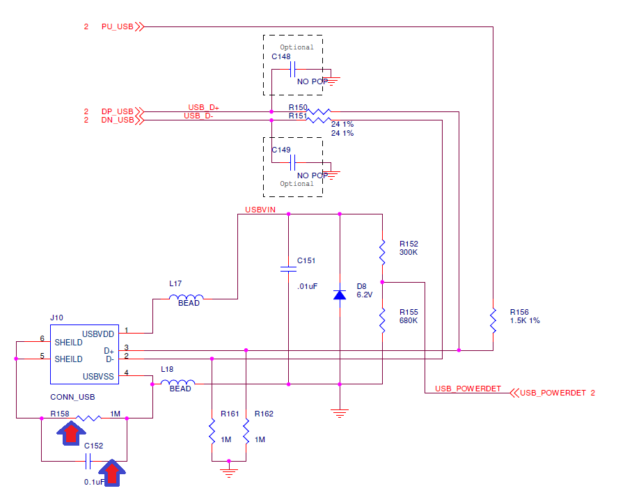

    Why this resistor and this capacitor is used in the image bellow?
    This image is taken from Spectrum Digital DSK5509A  schematics. J10 with 6 pins is a USB socket and the nets USB_D+ and USB_D- are connected to TMS320VC5507 usb pins.
    This is a typical shield-ground connection. If you connect the shield directly to the board ground you create a direct path from the ground plane to the shield and you risk turning the USB FS cable into an antenna. To limit this effect you should connect the shield to the ground through this RC filter.
    Thank you for your answer. As you mentioned it is a RC filter between ground and shield, but since I usually don't connect the USB socket shielding pins to anywhere so that I don't use this RC filter.
    Which method do you recommend?
    The RC filter is also for ESD absorption - the cap takes the first flash of voltage and the 1M then keeps the current down so as not to hurt anyone.
    If you populate the USB recepticle, it is a common place for ESD events to occur (by touching it).
    Recommend keeping the two components, or adding an ESD component.
    So I have understand that RC filter play two roles in this circuit:
    1-(As Yordan mentioned first) To prevent USB FS cable become antenna.
    2-(As you mentioned next) For ESD absorption.
    In my opinion the first role is more important.
    Yes, this is correct. It is an ESD protection and prevents USB FS cable to become antenna.
    If you don't connect the USB socket shielding pins to anywhere you could skip these two components (NOT recommended), but as Mark mentioned it is good to use some ESD component so that you don't damage the components on your board in a possible electrostatic discharge.

    ・Is it correct that CC1 and CC2 pins that come in from the outside are pulled down with 5.1kΩ?
    ・Is it correct that set the AM64x pin (U16, USB0_ID) as not connect?
    AM64x does not have USB CC pins. It requires a companion device to implement USB Type-C.
    Connecting 5.1K ohm resistors from each USB Type-C CC pin to ground defines an Up-stream Facing Port (UFP), which defaults to device mode. You need to select a USB Type-C companion device and connect it as described in the respective device datasheet.
    The AM64x USB0_ID should be open-circuit when you are wanting the AM64x USB port to operate in device mode, or connected to ground when you are wanting the AM64x USB port to operate in host mode,  Note: You should never connect the USB0_ID pin to a circuit capable of sourcing current.  The USB0_ID pin should only be connected to a circuit that sinks current.
    A UFP is expected to monitor the voltage of the CC pins to determine current sourcing capabilities of the DFP. The detection thresholds are 0.2V, 0.66V, and 1.23V. The DFP is capable of sourcing 500mA if USB 2.0 or 900mA if USB 3.0 when the UFP detects a voltage between 0.2V and 0.66V. The DFP is capable of sourcing 1.5A when the UFP detects a voltage between 0.66V and 1.23V. The DFP is capable of sourcing 3.0A when the UFP detects a voltage greater than 1.23V.
    For this use case, you should be able to use the USB0_DRVVBUS pin as GPIO1-79 if you need another GPIO. However, this pin has an internal pull-down that is turned on by defaults, so you may need to account for it if you use the pin as a GPIO.
    Monitoring the voltage of the CC pins may not be required if you are not using VBUS to power any circuits in your system. I recommend you confirm this is the case by reading the USB Type-C specification.
    VBUS is not used to power the circuits in the system.
    In this application, it is used only as a device, so I understand that the CCpin should be a 5.1k pull-down.
    Please let me know if there is any discrepancy in my understanding.
    I think you are okay with these connections.
    I have some questions about connections between AM64 and TUSB320LA.
    Q1: What is absolute maximum voltage on USB0_ID pin?
    I'm going to skip this question for now because I do not think it is relevant.
    Q2: What is the first power source of USB0_ID pin from outside? Three source are written in datasheet.
    Q3: What is the threshold voltage for Low detection on USB0_ID pin?
    You should never apply any potential to this pin. This pin should only be connected to a resistor that is connected to VSS. There is a an internal circuit that measures the resistance of this pin to VSS. Different resistor values are used to indicate the USB mode of operation and the resistors values are defined in the USB specification.
    Q4: Is it able to connect the ID output of TUSB320LA to AM64 USB0_ID pin?
    Only if the TUSB320LA output looks like a resistor connected to VSS and does not source any potential to the pin.
    Q5: Is it able to pull the USB0_ID pin Low by TUSB320LA?
    Q6: Now we connect the PU resister in USB0_ID line. Is it okey?
    What is the threshold resistance to detect High or Low on ID pin?
    It seems that the open drain resistance of TUSB320 ID pin is 250 ohm, according to the datasheet (Max. Low-level output voltage of open drain is 0.4 V at -1.6 mA). Mr. Nagata taught me that.
    I have inserted a snapshot of valid ID resistor values as defined by USB-IF.
    I do not think you will have a problem with the impedance of the TUSB320 ID pin being able to indicate host function (RID_GND).  However, you need to be careful with one of the recommendations mentioned in the TUSB320 datasheet.
    The datasheet recommends the ID pin be connected to an external 200k ohm pull-up that is connected to the TUSB320 VDD 5V supply. This is a very bad recommendation without additional warnings related to potential EOS concerns when connected to devices like AM64x that cannot tolerate external sources, especially 5V sources. It is very likely the recommended circuit topology would destroy AM64x.
    The TUSB320 ID pin is not fail-safe and they do not want you to apply any potential to it when the device is not powered. The AM64x ID pin has an internal current source that will be turned on when software initiates a ID resistance measurement. The ID resistance measurement should never be performed while the TUSB320 device is not powered to prevent the AM64x device from sourcing current into the TUSB320 ID pin which is not fail-safe. This is something you need to understand and implement appropriate system level precautions that prevent this from occurring.
    I was not able to find the table of snapshot in datasheet version 3. Are you going to include the documents in the next datasheet version?
    We only reference the respective USB and PCIe specifications in the datasheet for these industry standard interfaces since AM64x is compliant to the standards.

  • Hi Board Designer,
    Inputs related to USB VBUS divider
    Your latest description seems to indicate the customer is planning to connect the USB port to a USB connector that is configured to operate as a dual-role device, where it can operate as a USB Host or a USB device. If that is the case, the customer must implement the voltage divider / clamp circuit as shown in the section 9.2.3. No exception.
    The VBUS voltage divider / clamp circuit shown in 9.2.23 is required to reduce the VBUS signal to a level that is acceptable for the AM62x VBUS input. VBUS is not expected to be greater than 5.5V unless the system negotiates a higher voltage on VBUS.  The Zener clamp portion of the circuit was included to protect the device if VBUS was accidently connected to a VBUS power source greater than 5.5V. The clamp function could be removed and the resistor values changed to apply the same voltage to the AM62x VBUS input if VBUS is limited to 3.3V. However, I recommend keeping the bias current through the voltage divider the same with 3.3V as the recommended implementation when 5V is applied.
    The PHY threshold levels are set based on the voltage divider ratio when the USB voltage potential is operating as defined in the USB specification. Therefore, the voltage divider needs to be implemented as shown in the datasheet for VBUS voltage levels to be compatible with the PHY thresholds. The Zener clamp in this circuit protects the AM62x VBUS input from an over-voltage condition. This can occur as discussed before when a power delivery device accidently applies the wrong voltage, but it can also occur when a USB cable is suddenly disconnected under load and the back-EMF from the cable inductance sources a high voltage back into the USB port. The AM62x VBUS input is connected to sensitive analog circuits implemented in an advanced process node and the Zener clamp protects these circuits from these over-voltage conditions.
    The voltage divider / clamp circuit design was provided by the USB PHY design team, and they set the PHY thresholds to operate within the VBUS limits defined in the USB specification when using this circuit. Therefore, the VBUS signal you connect to the voltage divider is expected to operate within the limits defined by the USB specification.
    Pulling up VBUS to an on-board 3.3V supply is not an expected use case defined by the USB specification. A system is expected to source 5V with a min current of 500ma to VBUS via a current limited load switch when operating as a USB host, or the attached host will provide the appropriate 5V VBUS when operating as a USB device.
    You mention your product would support dual-role operation. If so, VBUS would need to be connected to the 5V load switch, a Micro-AB connector, and the AM62x VBUS input via the voltage divider / clamp circuit. Therefore, I do not understand the use case where VBUS would be pulled to 3.3V.
    The design team did not define the PHY input thresholds or input current because they expected customers to use the voltage divider / clamp circuit as designed in a system operating as defined by the USB specification.

    ISOUSB211 is a galvanically-isolated USB 2.0 compliant repeater supporting low speed (1.5Mbps), full speed (12Mbps) and high speed (480Mbps) signaling
    When the power supplies on side 1 are up, this is indicated on side 2 by V1OK = High. Similarly, V2OK = High indicates that Side 2 is fully powered up.
    The digital output can be connected to processor USBx_VBUS to detect the connection of the supply when processor USB interface is configured for USB device operation.
    A pulldown 10K near to the USBx_VBUS is recommended. The recommendation is to connect the digital output from the USB isolator through a series resistor 100R for using as a divider Just in case.
    Connecting USBx_VBUS is optional for Host.
