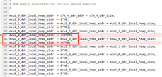

I tried to change the heap memory size of MCU2_0, after referring to the instruction manual, I changed the "
Rtos_sdk vision_apps/platform/j784s4 / rtos/gen_linker_mem_map.py " files, and execute the script, obtained the corresponding generated file. The changes are as follows:
Copy the contents of the k3-j784s4-rtos-memory-map.dtsi file to the appropriate path of the Linux SDK and compile and install it according to the instructions in the instruction manual.
    1. To generate the memory map related files do below
        cd vision_apps/platform/<soc>/rtos
        python3 gen_linker_mem_map.py
    2. Copy the contents of the generated k3-{SOC}-rtos-memory-map.dtsi file and replace the reserved_memory section of the k3-{SOC}-rtos-memory-map.dtsi file that is located here:
              PSDK_LINUX_PATH/board-support/linux*/arch/arm64/boot/dts/ti
    3.1  Rebuild the dtb and dtbo from the PSDK_LINUX_PATH directory with the following:
                 make linux-dtbs
    3.2  Install the dtb and dtbo to the rootfs/boot folder on the SD card from the same directory with the following
                sudo make linux-dtbs_install; sync
After compiling and installing both the RTOS and Linux into the SD card, boot the system:

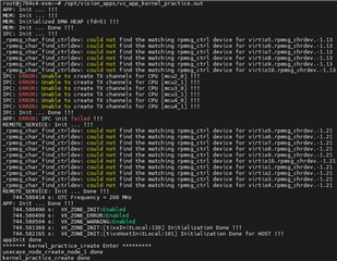

        From the memory size and memory address, you can see that I have configured it successfully.
Running my test program produces the following error:
What is the cause of this problem? How to fix it?
Above, thank you

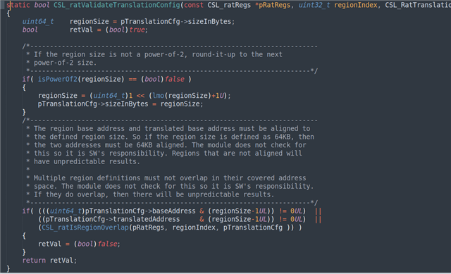

    Could you please share me the system_memory_map.html file that is generated from the python script?
    It looks like you might have crossed the 2GB DDR space and entered 64bit address space for R5.
    Nikhil

    c7x_4_ddr_scratch_non_cacheable_size = 32*MB;
    c7x_4_ddr_scratch_addr = c7x_4_ddr_scratch_non_cacheable_addr + c7x_4_ddr_scratch_non_cacheable_size;
    c7x_4_ddr_scratch_addr_phys = c7x_4_ddr_scratch_non_cacheable_addr_phys + c7x_4_ddr_scratch_non_cacheable_size;
    c7x_4_ddr_scratch_size = 32*MB;
    total_c7x_4_scratch_ddr = c7x_4_ddr_scratch_non_cacheable_size + c7x_4_ddr_scratch_size
    total_c7x_4_ddr = total_c7x_4_local_ddr + total_c7x_4_scratch_ddr
    total_c7x_ddr = total_c7x_1_ddr + total_c7x_2_ddr + total_c7x_3_ddr + total_c7x_4_ddr
  • This section is the content of the gen_linker_mem_map.py file, which captures a configurable section.
    The memory changes looks correct. It did not cross to 64bit region because I see that you have reduced the SHARED_MEM to 480MB and uboot relloc size to 32MB.
    Is this changes done by you? because these are not the defualt values of SDK.
    Also, the C7x heap and scratch sizes are reduced to 32MB from 128MB in SDK.
    Could you let me know what this test program is and can you share me full logs of the boot, remote core logs and your application?
    Please provide it in the form of a file (not screenshots).
    You could upload a file by drag - drop into the e2e replies.

  • HI
    The part of the memory modification you pointed out is my change, because the total capacity of the DDR I use is 8GB.

    I see a gap between these 2 regions. Here for RAT, we are giving both the regions. I'm suspecting the failing of RAT because of this GAP. Could you try to remove this gap?

    The current issue here is that all the R5 cores are hung and the IPC initialization is not yet happened. You would have to check the exact region of Hang either through more logs or by connecting CCS.
    Nikhil

    The issue here is not ipc communication failure.
    The main reason for the ipc error is because the R5 cores are stuck / hang before IpcInit() from the vision_apps remote core logs. So we would have to check where exactly the R5 cores are hung.
    We could use CCS to identify the same.

    root@j784s4-evm:~# /opt/vision_apps/vx_app_kernel_practice.out
    APP: Init ... !!!
    MEM: Init ... !!!
    MEM: Initialized DMA HEAP (fd=5) !!!
    MEM: Init ... Done !!!
    IPC: Init ... !!!
    _rpmsg_char_find_ctrldev: could not find the matching rpmsg_ctrl device for virtio4.rpmsg_chrdev.-1.13
    _rpmsg_char_find_ctrldev: could not find the matching rpmsg_ctrl device for virtio6.rpmsg_chrdev.-1.13
    _rpmsg_char_find_ctrldev: could not find the matching rpmsg_ctrl device for virtio7.rpmsg_chrdev.-1.13
    _rpmsg_char_find_ctrldev: could not find the matching rpmsg_ctrl device for virtio8.rpmsg_chrdev.-1.13
    _rpmsg_char_find_ctrldev: could not find the matching rpmsg_ctrl device for virtio9.rpmsg_chrdev.-1.13
    _rpmsg_char_find_ctrldev: could not find the matching rpmsg_ctrl device for virtio10.rpmsg_chrdev.-1.13
    IPC: ERROR: Una[   57.675485] kauditd_printk_skb: 1 callbacks suppressed
    ble to create TX channels for CPU [mcu2_0] !!!
    IPC: ERROR: Unab[   57.675494] audit: type=1701 audit(1708486399.182:15): auid=4294967295 uid=0 gid=0 ses=4294967295 pid=746 comm="vx_app_kernel_p" exe="/opt/vision_apps/vx_app_kernel_practice.out" sig=11 res=1
    le to create TX channels for CPU [mcu2_1] !!!
    IPC: ERROR: Unabl[   57.704162] audit: type=1334 audit(1708486399.210:16): prog-id=13 op=LOAD
    e to create TX channels for CPU [mcu3_0] !!!
    IPC: ERROR: Unable[   57.716420] audit: type=1334 audit(1708486399.222:17): prog-id=14 op=LOAD
     to create TX channels for CPU [mcu3_1] !!!
    IPC: ERROR: Unable to create TX channels for CPU [mcu4_0] !!!
    IPC: ERROR: Unable to create TX channels for CPU [mcu4_1] !!!
    IPC: Init ... Done !!!
    APP: ERROR: IPC init failed !!!

    Note: Once you have modified the DDR configuration script, as long as it is executed using python3, the modifications are then generated, along with the.dtsi device tree file in the Linux sdk.
    However, in the first modification, I did not copy the .dtsi device tree file into the linux sdk, and the R5 core was running normally (MCU2_0 reaches the "App Run.. Done" log), I then copied the generated.dtsi file into the linux sdk and compiled it.
    After running the system again, the situation is the same as before.
    This means that whether or not I copy the.dtsi file into the linux sdk has no effect on the running of the R5 core. This does not seem reasonable.

    I'm able to reproduce this issue at my end.
    If I increase the value of mcu2_0_ddr_local_heap_size to any value above 8MB, i'm getting "appMemAddrTranslate(): Error in CSL_ratConfigRegionTranslation()" and hang in all the R5 cores.
    Let me deep dive to find the root cause of the same.
    I shall get back to you by tomorrow or early next week.
    Nikhil
    Good news.
    I found the root cause of this issue.
    The cause for the hang is because of this statement APP_ASSERT_SUCCESS().. This will put it in a while loop in the status is not returned success, which is happening in your case from the error log "appMemAddrTranslate(): Error in CSL_ratConfigRegionTranslation()"
    Now the root cause of this issue why there is a rat configuration error is because of the below statement in ${PSDK_RTOS}/pdk_j784s4_09_01_00_22/packages/ti/csl/src/ip/rat/V0/priv/csl_rat.c
    Here, your region size is which is 512 MB (0x20000000) and the baseaddress of DDR_SHARED_MEM (when 8MB) is 0xC0000000 which is aligned to 512MB.
    But the base address of DDR_SHARED_MEM (when 128MB) is 0xC7800000, which is not aligned to 512MB, causing this error.
    Now what I did to check this is to reduce region size to 256 MB (0x10000000) and the baseaddress of DDR_SHARED_MEM (with 128MB and INTERCORE_ETH_DATA_MEM region increased from 24MB to 160MB  --> so that the baseaddress would also be increased from  0xC7800000 to 0xD0000000) is aligned to 256MB.
    This is working fine for me, and I don't see any error now.
    Hence, I would suggest you align the DDR_SHARED_MEM baseaddress to the region_size
    (DDR_SHARED_MEM_SIZE + UBOOT_RELOC_MEM_SIZE) and this should resolve your issue.

    You would have 2 options here.
    1. To adjust the memory that you are using such that the resulting ddr_shared_mem_addr would be aligned as per requirement.
    2. To hardcode the DDR_Shared_MEM to an address such that it is aligned as per requirement. Here you would have to ensure that the ddr_intercore_eth_data_addr + ddr_intercore_eth_data_size <  ddr_shared_mem_addr.
    Nikhil
