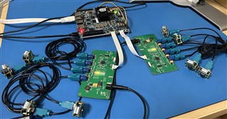

How can I enable CSI2 sensors via fusion boards such as Arducam V3Link or fusion 1 daughter board (EVM577PFUSION-V1-0)?
  • Arducam V3Link Mini Fusion
    Learn more: https://www.ti.com/tool/ARDCM-3P-V3LINK-CAM
    Sensors supported out-of-box: IMX219 & IMX390 (RCM)
    Compatible edge AI devices: SK-AM62x, AM67 EVM, SK-AM68 & SK-AM69
    Device tree overlay: k3-<device>-v3link-fusion.dtbo
    Power up sequence:
    1. Power on V3Link board FIRST
    2. Power on SK/EVM SECOND
    Power down sequence:
    1. Disconnect power from SK/EVM board FIRST
    2. Disconnect V3Link power SECOND
    If you are using two Mini Fusion boards to your EVM, use the CS0 ports and connect to each CSI port on your EVM.
    Note: Mini Fusion is not enabled for SK-TDA4VM nor is it supported on PSDK Linux/QNX + RTOS platforms
    The CSI header (on SK/EVM) that the V3Link is connected to via ribbon cable and the FPDLink port being used by your sensor on the V3Link will let you know which v3link sensor overlay to enable because the naming convention is as follows: k3-v3link-<sensor>-<CSI-header>-<FPDLink-port>.dtbo
    To keep things simple, I recommend connecting the the ribbon cable to CSI0 (on SK/EVM) and CS0 (on V3Link). Connect your sensor via RX0 (on V3Link) and enable k3-<device>-v3link-fusion.dtbo and k3-v3link-<sensor>-0-0.dtbo.

    Device tree overlays required for 8x imx219 setup: k3-v3link-imx219-0-0.dtbo k3-v3link-imx219-0-1.dtbo k3-v3link-imx219-0-2.dtbo k3-v3link-imx219-0-3.dtbo k3-v3link-imx219-1-0.dtbo k3-v3link-imx219-1-1.dtbo k3-v3link-imx219-1-2.dtbo k3-v3link-imx219-1-3.dtbo
    Note: After making the changes to uEnv.txt, reboot & run /opt/edgeai-gst-apps/scripts/setup_cameras_v3link.sh
