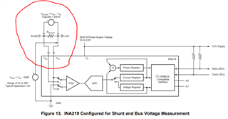

  • Hey Louis,
    Below is the picture of my connections:
    I'm reading bus voltage register, but I'm getting very low voltage.

  • Shamita,
    I feel I could better help you if I could get a schematic of how you're circuit is wired up. It's difficult to see everything in the picture and it looks like the coupon board you have with  the INA219 on it is not our EVM, so I don't know which pins are IN+ or IN-. From the pics, it looks like your shunt resistor is connected on the low side (assuming red is high side and black is low). If that's the case, your bus voltage results will be very low because, like I mentioned previously, that result comes from the voltage at the IN- pin with respect to GND.
    I'm also not sure why you are shifting the register value to the right 3 bits. The raw value in the Bus Voltage Register is the hex value of the bus voltage, and the only calculations required are to convert it to decimal, then multiply that result by the 4mV LSB to come up with the Bus Voltage result.
    Yes, the equation you pasted is the correct equation to calculate the value to program in to the Calibration Register (once you calculate the Current_LSB first).
    Louis

  • Shamita,
    I'm sorry but I still can't see the connections being made and am not familiar with the coupon board you're using. Without a schematic I don't know exactly where the signals are going.
    My only suggestion right now is to ensure you're following the suggested connections to measure the bus voltage from figure 13 in the datasheet.
    Secondly, my apologies, I forgot about shifting the bus register 3-bits.
    One thing you could do to help troubleshoot this is probe the IN- pin while you have the shunt connected. After you probe that pin and get the voltage, send a command to trigger a measurement, then read the bus voltage register.
    Could you also do a register dump and show me what all of the registers are reading?
