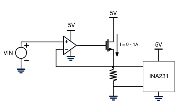

I'm trying to use the INA to measure output current across a shunt resistor in a current sink for the amplifier independent study in my rotation. I'm pretty sure the hardware for the EVM is configured correctly after reading the user guide, but I'm getting issues with the software (I believe).
I have A0 and A1 set to GND. I'm trying to operate in Shunt and Bus, Continuous mode with an Averaging Mode of 1. My bus and shunt conversion times are both set to 140 us. I'm configuring based on the Current LSB. I input a resistance of 1.7 ohm and max current of 2 A (should only get to about 1.5 A, so this can be changed) for a current LSB of 100 uA. I'm not configuring any alerts. However, when I hit Read All Regs after pressing Write All Regs, no voltage is read across the shunt resistor (or current) and the operating mode changes to Power Down. I know from measuring the shunt resistor with a multimeter that there's a voltage across it, but that's not being read by the INA. What might be the problem?

  • This is the physical setup of the circuit. Note that the VIN- and GND pins on the EVM are shorted. Below is the schematic of my circuit:
    The VIN+ pin is connected to the same node as the source of the NFET and the inverting input of the op-amp.

  • Hey Matthew,
    Is the 5V source for the device as the 5V source for FET and load?
    Can you please repeat the video, but with the registers tab opened, I don't see anything indicating that the device is going into power down?
    What is the approximate current going through FET during the test via measuring the voltage drop across the shunt resistor or by looking at source current readout from the 5V source instrument?
