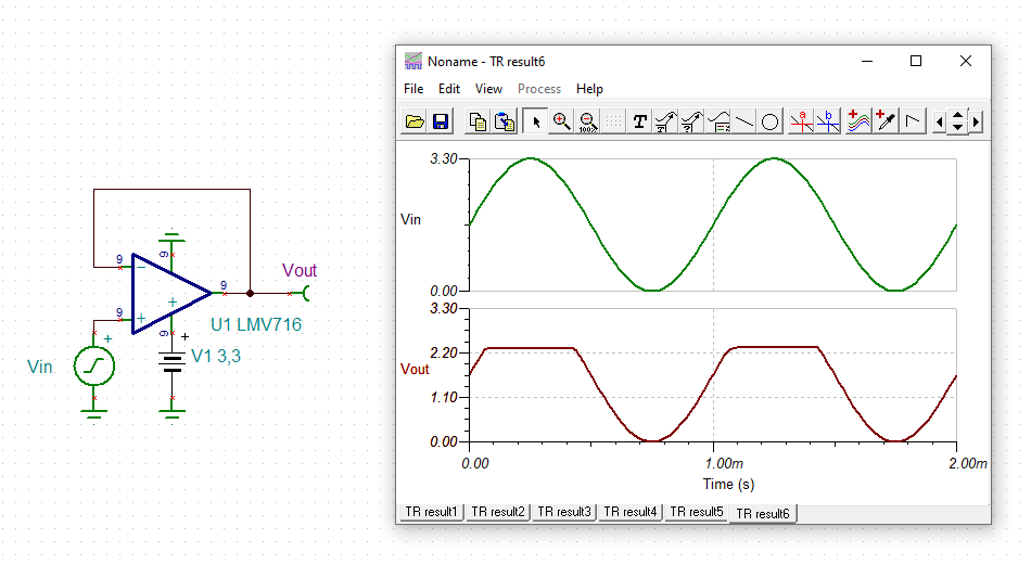

During testing at Flextronics, ICT showed that the output of the LMV716 can only swing to about 2.4V. The data sheet shows that it can swing almost to the 3.3V rail (the power supply). We are seeing this on 25 products so far, and are concerned that it does not meet TI’s own specifications. Testing we have done in the lab has confirmed that the LMV716 does not meet its own specification.
