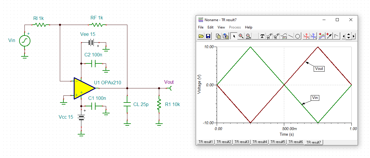

  • Hi Carlo,
    works for me in TINA-TI:
    carlo_opa210.TSC
    Kai

  • Hi Carlo,
    I can import the lib-file into TINA-TI and this is also working. About the olb-file I cannot say anything.
    You could try to run a triangle wave of low frequency:
    Kai

  • Hi Luis,
    I simulated a DC sweep of a simple buffer, from which you can see an offset for negative voltage and a discontinuity in zero.
    Furthermore, this kind of simulation is typically executed in a fraction of second, but with this model it takes almost 10 seconds.
    Please find attached the test project.
    opa210_test.rar

  • Hi Carlo,
    Extensive efforts involving engineers from our applications and and modeling teams have been made to reproduce the OPA210 PSPICE for TI anomaly you describe. The OPA210 model readily and quickly simulates using PSPICE for TI, Cadence 17.4 and TINA-TI as mentioned previously. Additionally, I just tested the model using another PSpice compatible simulator TopSpice.
    The OPA210 model easily and quickly simulates without incident with this simulator as well. The results are seen below for the OPA210 configured as a follower with a -10 V to +10 V DC input sweep applied. I tried several other configurations and analyses and the model readily produced the expected results nearly instantaneously for each simulation performed.
    Our findings suggest there is possibly something not correct with your PSPICE for TI installation, or there is a setting that is causing the different results. Do you have access to another computer that has a PSPICE for TI installation that you can load and try your circuit? Or better yet, access to another computer where you can do a fresh PSPICE for TI installation and then try your simulation circuit again?
    Regards, Thomas
