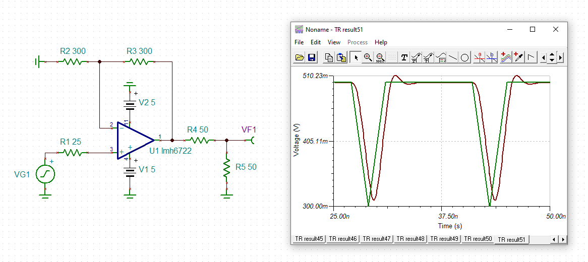

Our signal is about 2 ns falling time(500mV->300mV) of negative pulse.
like here:
I'd like to fanout a signal from 1 to 8.
I think using LMH6722*2 to make fanout circuit, which signal I/O is from the func-gen through fanout board, finally go to scope.
If I just adopt LMH6722*2, in addtion to "50-ohm I/O terminated impedance matched", what should I care about?
LDO is necessary?
My basic consideration as following picture.
Where are can be improved?
Could anyone give me suggestion?
