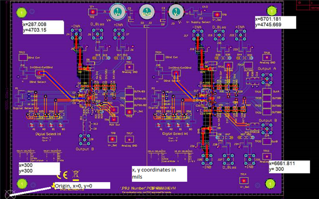

Hi All,
I need help on locating the stand offs location H1 H2 H3 and H4 for the OPA3S328EVM mounting over the bracket, can any one help me in getting the values from any of the reference origin in the PCB board,
pictorial representation well appreciated thank you in advance,
Chandra
  • Hello Chandra,
    Attached is the the pick-and-place excel file AMPS084A_PnP.xls.  The excel file contains the x, y coordinates of each  component on the OPA3S328EVM. The file lists the coordinates for the component's center point, based on source PCB library x, y location in imperial units (mil) and metric units (mm).
    AMPS084A_PnP.xls
    Below is a drawing to show the positions of the screw holes for the stand mounts. I took a snapshot of the PCB board layout and extracted the coordinate x, y locations for the screw holes from the pick-and-place excel file. The origin of the x, y coordinates is at the bottom left corner.
    Below is a Zip file for the Altium database and PCB Gerber files so you have access to all the information in the PCB design:
    AMPS084_sep_07-2022.zip
    Gerber_NCdrills_IPC.zip
     Thank you and Regards,
    Luis
