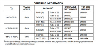

An IBIS model is something for digital chips but not for OpAmps. We only have a PSpice model for the LM348. The LM348 behaves similarly to the LM148, but can have a higher offset voltage. Please see attached the comparison table.
