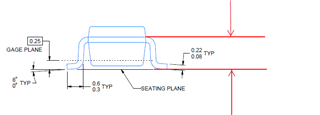

I'm trying to determine the distance between the bottom of the foot (seating plane) and the top of the lead for VPN TLV3501AQDBVRQ1. If TI would specify this dimension on all of your drawings it would save me a lot of work getting parts measured.

Thanks for the post. Information regarding the package drawings is usually included in the back of the datasheet. See page 20: TLV3501A-Q1 4.5-ns Rail-to-Rail, High-Speed Comparator in Microsize Packages datasheet (Rev. B) (ti.com).
The distance is between typically 0.08 mm to 0.22 mm.
I hope that answers your question.

Thanks for the quick reply. That's not the dimension I was looking for. I'm looking for the distance between the bottom of the foot (seating plane) and the top of the lead that goes into the package, see below.

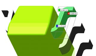

Thanks for your help. I was able to use the .stp file along with Creo viewer to look at the file. When I used the file it's showing me that the lead dimension Z would be about 1.175 mm, not 0.9 ±0.1 mm.
Any idea where there is a difference between the two?

The 0.9mm number came directly from the assembly site...so I would trust that. The TLV3501-Q1 is only assembled at one site.
There can be differences between the assembly sites - as they do use different tooling.
I believe the drawing is a cover-all, following the JEDEC MO-178 spec.
Paul, Thanks for the information. So, would it be safe to say that all TI part with DBV package the model would be 1.175 mm max? or would there be a tolerance on the Z dimension?
We have a critical value of ≤ 0.787 mm.

The critical value of ≤ 0.787 mm is what we use to determine if we need any additional mitigation for tin whisker growth.
If it could be specified as a maximum value that would be a tremendous help for us.
