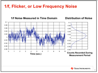

    Can it be more than x/2 on either the positive or the negative side?
    Pulling a slide from the presentation I linked, you can see that there's a difference in the max and min. However, because 1/f is very low frequency noise, if you had a longer time sample, the gaussian curve would be closer to zero.
    The Vpp values that are given in sheets are within how many sigmas of the distribution?
    The typical values are +/-1 standard deviation, or about 68.3% of the distribution.
