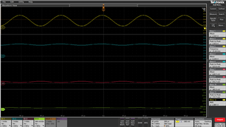

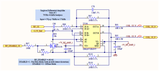

I have the attached circuit built onto a PCB.
It is essentially intended to take a 5V sine wave input of varying frequency, and outputs a differential waveform which applies power over a ~27R load, with a small amount of filtering.

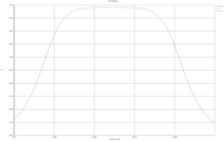

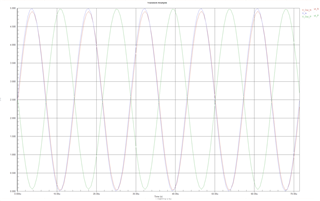

The circuit successfully simulated using the pSpice model provided on the product page, (simulated within altium).

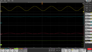

However in reality it appears to output a wave with a tiny amplitude and large DC offset.
Can anyone make any suggestion why I am seeing the results shown on the oscilloscope screenshot, rather than those shown in the simulation?
And what may be done to resolve this issue?
Thus far all I can glean is that my setup of A1/A0 may not be ideal.
(Doesn't seem to drive above 2V as intended. Though does to exceed the absolute maximum of Vee+5, which could be the problem).
How should the bias pins be driven, if a negative supply of under -3V is used?
(If A1/A0 is referenced from GND and requires at minimum 2V for logic 1).
(Scope Screenshot Ch1 - RF_1X | CH2 - COIL_1X_P | CH3 - COIL_1X_N  | CH4 - A0/A1)
Thanks, Andrew

  • Hello Andrew,
    I am still working on your circuit and analysis.  However, I thought it would be helpful to share my two TINA-TI SPICE simulation files.  I would suggest acquiring TINA-TI and using the two circuits I provide to investigate if your design truly functions as you intended.  The first file is a copy of the OPA2673 TINA Reference Design file, setup to be able to output a sine signal and has working enable/disable.  You set A0 & A1 to 0V to operate at Full Bias, and set the values to 2V to disable the part.
    The second file is a working version of your schematic; this includes the MOSFET for disable, as well as a switchable path for A0/A1 BIAS to just use a DC source.  It would appear from the TINA-TI simulation that the circuit is not behaving as intended.
    I hope this helps you understand what I am seeing, and helps towards the resolution of your design.

  • Hi Alec,
    Thanks for responses and simulation files. Certainly helped more than the model I had in Altium.
    In the end it didn't seem to be an issue with the enable, i suspect it was more that I was supplying the IC from imbalanced voltage supplies... (+7V / -5V).
    I've ended up going single supply (+12V), introducing a DC offset, and using a blocking cap on the output. Which seems to now work within the parameters of what I need at least!
    Thanks for the assistance,
    Andrew
