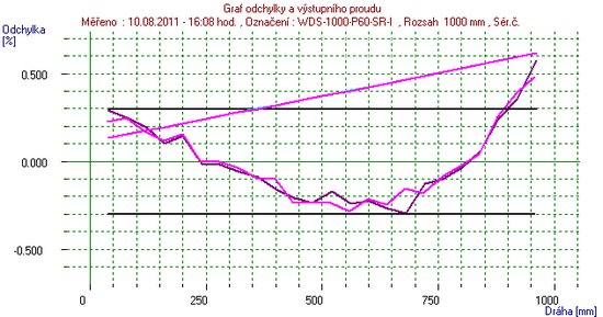

I have a problem with linearity chip XTR116, my circuit is connected according to FIGURE 1. Nonlinearity chip is 0.003%, potentiometer have nonlinearity under 0.1%. I need all nonlinearity under 0.1%, but when I measure this circuit, nonlinearity is bethween 0.3 to 0.4%. You know,  what could be a problem ?

    What is the X axis in the graph?  I did a google translate from Czech to English and received "track" as the translation for the X-axis and "Deviation" for the y-axis.  Is this some type of linear actuator?  What do the three plots represent on the graph?  There are two that look similar and a third very linear plot.

  • Chip XTR116 I will use als 2-wire current electronic for Draw-wire displacement sensors. I tried chip XTR101, this solution was very good, but I search chiper solution and I select XTR116. Draw-wire displacement sensor have measuring range 1m, this is axis X in graph
    (distance in mm) and Y axis  is Deviation from linearity.  In graph are tree plots represent course deviation from linearity measured distance from 0 to 1m  (first plot) and from 1 to 0 m (second plot). Last plot (very linear) is course of current.
     Potentiometer is linear and for range 0 to 1m of sensor  is from zero-scale to full-scale. The potentiometer's resistance is verified and have linearity under 0,1%.

     I have the output precise resistor 250ohm connected and I measure voltage across the resistor with Keithley. For plots in graph  I converted back to current.
                   Martin

  • Dear All,
     thanks for your suggestions and discussion. You were right. Problem was in external components. I joined OPA33 to XTR116 and I performed additional tests. Below are graphs and my results.
    Graph 1- XTR116 without OPA33   - bad linearity (greater than 0.2%)
    Graph 2- XTR116 with OPA33    - linearity better (less than 0.2%)
    Now, I measured only poti, linearity very good, less than 0,1%.  I then measured the potentiometer with other external components (input XTR116)  - graph 4
        Graph 3- only potentiometer 1k
    Graph 4- potentiometer 1k with external components (rezistors and trimmers)
    There was bad linearity - (0,5%) - problem is in input circuit from external components. I change schematics input circuit (I added 1k rezistor in parallel with potentiometer) and now is linearity less than 0,1%
