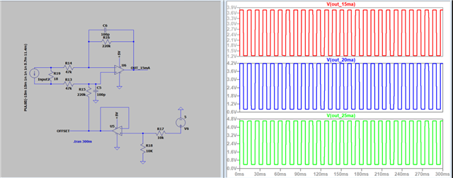

    As I mentioned above it's a current source of -20mA to +20mA ( Varies +-5mA from nominal value). Circuit is attached.
    What I am trying to achieve is that if the current falls beyond +-15mA, +-25mA, I shall be able to detect the difference on analog pin of ADC.
    I have created the circuit using op-amp, and buffer, I am able to shift the Pwm to positive but when I convert to Analog to feed to ADC the margin i am getting is very less (0.05V). So i need some suggestion on that.

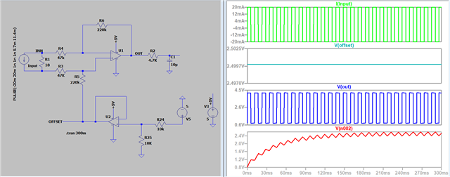

  • Hi Deepak,
    Not sure if I totally get what you meant by “ the margin I am getting is very less (0.05V)”. I’m guessing this is referring to the output after the low pass filter?
    If so you would want to make R2+C1 much smaller. As it is reduced, you'll notice the nodal voltage starts to resemble V(out) more.

    As you can see from the circuit, I am sensing the Differential current (±15mA to ±25mA) across 18ohm resistor. Since current is negative going so I am offsetting it by 2.5V.
    Output I am getting is as below at each current: I am feeding this Pulsating DC out to ADC pin and sampling the average of it. But the problem I am finding is that at both 15mA and 25mA the average is 2.5V so ADC won't be able to distinguish if the current is 15mA or 25mA.
  • Hi Deepak,
    The PWM signal is symmetrical w.r.t. OFFSET. Regardless its magnitude, the average will be the OFFSET. The circuit is behaving exactly as it should.
    A different indicator should be measured instead. One option is to have a peak detector, where different magnitudes yield different peak values. There are examples of such circuit online, I believe you’ll be able to reference to and accomplish the design goal.
