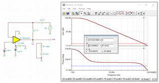

  • Hi Uttam,
    Based on the enclosed schematic, there is no or very low capacitive load at the output of OPA4350 op amp. The slide switch only operates statically and its parasitic capacitance should be low.
    OPA350 capacitive load 03182024.TSC
    Without capacitive load at the output of OPA350, non of these 100mΩ and 22uF are required, and OPA350 has plenty phase margin at 67 degrees.

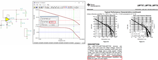

    If this assumption is correct, the phase margin of LMP7709 is very poor, and it is not unity gain stable. LMP7709 op amp is decompensated op amp and will require gains > 6V/V in order to be stable.
    Why do you want to use such old part for the buffer? Please advise.
    Raymond

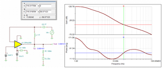

  • Hi Uttam,
    We have many op amps that will meet the customer's need, if this is the cost issues.
    If this is dynamic transient instability issues, I would recommend to remove 100mohm and/or 22uF, disconnect the snubber compensation, the OPA350 should be stable (assume that there is little or no capacitive load at the buffer's output).
    I am going to close this inquiry for now. If you have other questions, please let me know.
