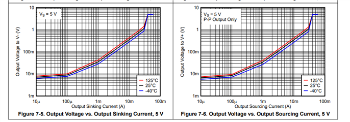

    Sinking and sourcing current from the output will result in a voltage drop from V+. Here's a snippet from our TLV1811 datasheet.
    Running at 20kHz 10% duty cycle shows the comparator sourcing about 6.5mA of current, which results in about a 200mV drop from V+, so your output can only reach a theoretical ~6V.
    Whereas with 90% duty cycle, the comparator is sourcing about .7mA which results in a 30mV drop from V+.

  • Hello Michael,
    Thanks very much for the detailed response.
    Due to diff current consumption of the comparator , We are observing the drop across the output.
    But why is there change in current consumption based on duty cycle?
    Is it like internal MOSFET is not completely turned ON? Please provide your view!
  • The capacitors in your RC filter are also maintaining the voltage.
    So, when there is a 90% duty cycle the comparator sources a small amount of current on HIGH to get ~6.2V on Vout1, while on LOW it sinks ~6mA. Vice-versa on the 10% duty cycle.
    You can see there is much more current pulled in at t=0 on 90% duty cycle, and Vout2 is much wavier on its output.
    To put it another way, if you were to use a purely resistive load then AM2 would have the same current on HIGH/LOW regardless of duty cycle.
    This is the basic design of push-pull. It's also helpful in understanding why there is that voltage drop because of the FETs.
