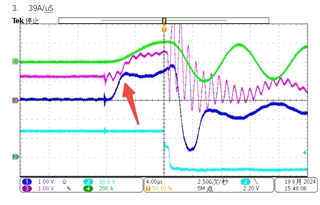

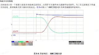

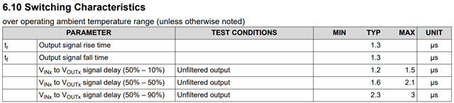

Hi every one,
Recently, when we used AMC3302-Q1 and TLV316QDBVRQ1, we found that when the current rise slope is below 20A/us, the output voltage is relatively accurate, and when the current slope is dozens of A/us, the voltage value is larger after the difference is converted into a single-end output. What causes this?  (The value of the shunt is 0.1mΩ, and the AMC3302 magnification is 41.)
