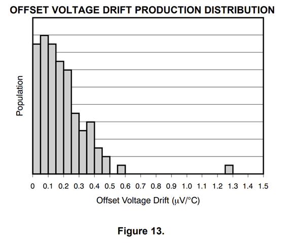

  • Thanks Chris, as i mentioned in my original inquiry text,  parameters like open loop gain, Vos, Ib are critical in our application. The output of our thin film pressure sensor is 2mV/V (6 mv Full scale). Any significant temp variation of these parameters will be undesirable .
  • Hi Nader,
    Understood. We can only go off of what is in the table. The offset voltage drift is good at 2 uV/deg C but looking at the histogram it is on average is even better.
    The input bias current is already in the 100's of nA so over temperature I don't expect a drastic change like CMOS devices where the Ib doubles every 10 degrees C due to ESD diode leakage. I would say if your application can tolerate the typical and max Ib from this device it isn't going to double every 10 deg C like that of a CMOS.
    The Aol is actually really good at these temps. Looking at T = 210 C the typical Aol is 118 dB or 1.26 uV per every 1 volt step on the output for the 10k load. The open loop gain will reduce with heavier loads so if you can minimize the output load that will help. Additionally you can see that going from 125 to 210C the Aol is fairly well mainained for that large of a temp increase.
