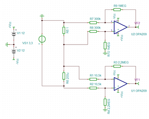

  • Hello, Raymond!
    The circuit I am using is shown below. At the relay inputs, I am applying 1mV, and the relay outputs go directly to the ADS131M08. I have removed the diodes for +VCC and -VCC from the circuit, and I am changing the resistors for testing purposes.
    The results I obtained from the latest data collections with 1mV at the input were:
    • With attenuation: Using an input impedance of 1MΩ per channel and a feedback resistor of 300kΩ, I observed a variation of 8.6%, with the measured voltage ranging from 1.987mV to 2.676mV. In this case, the equipment had just been powered on after being off for a long time.
    • With unity gain: Using 10kΩ impedances, I observed a 1.225% error, with the voltage ranging from 1.214mV to 1.274mV. Similarly, the equipment had just been powered on after being off for a long time.

  • Hi Felipe,
    OPA4209 is bipolar precision op amp, and the Ib should be in ±1nA (typ.) to 8nA range. With the low input difference voltage of 1mV, the Ib feeback current is too low for the topology. It would be better to use op amp with CMOS construction. Of course, OPA4209 is low noise op amp, you should not use 1MΩ (resistors' thermal noise) or even 10kΩ feedback resistor for such low differential input voltage. Use 1kΩ to a few hundred ohm feedback resistors for 1mV differential signal would be better. My guess is that your input and feedback resistor values are too high for the small input signal.

  • Hello, Raymond!
    I am using the OPA4209 to measure voltage across a load and a shunt resistor. This measurement is performed using a 4-wire configuration, and I provide the applied resistance value at the measurement terminals as the output. In summary, my application is an ohmmeter.
    In the current circuit, I am encountering an issue when measuring the 20kΩ shunt resistor. The response provided by the OPA4209 is not linear when my input impedance is lower. In the case I demonstrate below, my load resistor can vary between 100Ω and 1kΩ. It is noticeable that the response obtained in the TINA software is also not linear when I use a 4.7kΩ input impedance.
    However, when I increase the input impedance, the response becomes more linear. In this case, I apply a gain of 21.27 and am forced to increase the input impedance to achieve a more linear response. Of course, I do not provide only 1mV at the input but rather a range from 12mV to 120mV.
    In the cases I mentioned in previous posts, where I am applying 1mV, I am already using a higher impedance to try to mitigate the OPA4209's non-linear response. In a real application, I will not apply such a low value. The real case I tested on the bench is as follows:
    • OPAMP1 – Input voltage: 2.9994V – Attenuation of x0.3
    • OPAMP2 – Input voltage: 599.88µV – Gain of x209
    In the case demonstrated above, most of the variation occurs in the channel that applies an attenuation of 0.3, causing oscillation in my resulting value. In this scenario, I am applying a voltage lower than 1mV but with a gain of x209.

  • Hi Felipe,
    The nonlinearity is due to the voltage divider circuit near the GND side, where 40kΩ || (feedback resistor). One configuration 40kΩ is less sensitive to high feedback resistor network.
    In other words, two difference amplifier configuration is not apple to apple comparison.
    The OPAx209 is highly linear, though there is no data published from the linearity figures (the datasheet is published back in 2008). If you compare 3rd input resistance or more points in the middle of the curvature, you will see the difference more clearly.
