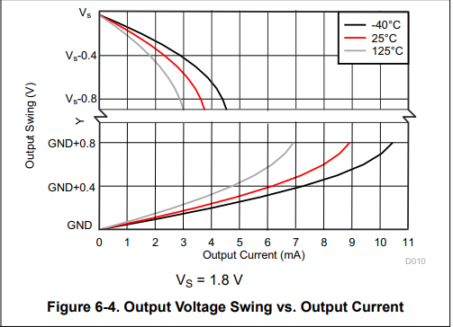

My customer has a question about the output specifications of INA186A1IYFDR.
Please tell us the output current or power specifications of INA186A1IYFDR.
Thank you.
JH
Hi JH,

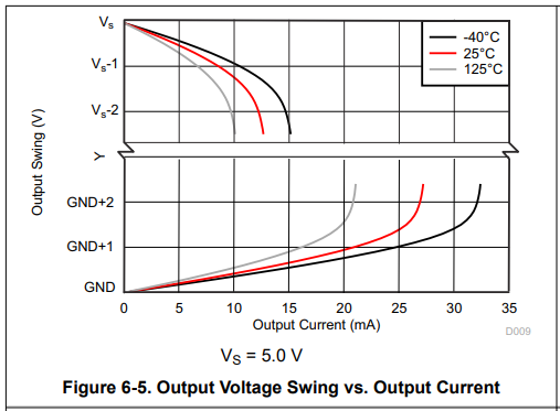

As Clemens said, the output current and power depends on the Vs and output swing which is depicted in the following graphs.
Mallika Senthil

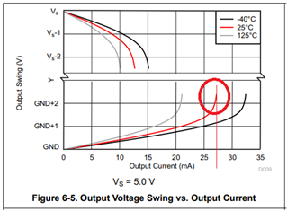

Hi Mallika,
Thank you for your reply.
Could you please elaborate on how to interpret the graph below?
Is it correct to assume that the maximum output source current at room temperature is about 27mA when VS=5V and maximum swing?
Why are the graphs in the upper and lower areas different?
t?
JH
At 25 °C, a typical device will be able to sink 27 mA, if the output voltage is more than 2 V (and only 12 mA when sourcing current).
If you need to go nearer to the supply rails, the output current must be smaller.
