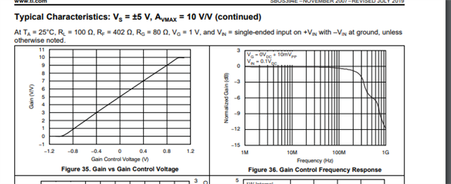

    I did find a curve for Av_max = 10V/V where a Vg = 0 setting results in Av = 5 V/V:
    You should try Rf = 402 Ohms; the Rf in a VGA product (variable gain amplifier) is not directly setting the signal gain; the Rf and Rg only set the maximum gain.  You can choose to set the maximum gain to 5V/V if you would like, otherwise you can use the Av_max = 10V/V example and set Vg to zero.

    I noticed that you changed the Rf value to 402 Ω to achieve a gain of 5 V/V. However, based on the datasheet, the gain should be approximately 2 × (Rf / Rg), which in this case results in 10 V/V. Is there something I might be overlooking?

    Your understanding is correct; I had set the name of the resistor to 200 Ohms instead of the value of the resistor.  The maximum gain is set by 2 x (Rf / Rg); when you use Rf = 200 Ohms and Rg = 80 Ohms, the maximum gain is set to 5V/V.  With VG = 0 to observe ~ 2.5V/V gain, and with VG = 1V I observe ~5V/V gain.
    The difference between ideal and simulated values may be due to the gain error and limitations of the design of the VCA82x devices.
