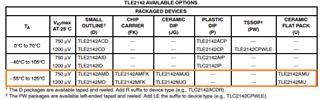

    The following package is suited for aerospace application.
    If you have other questions, please let me know.
