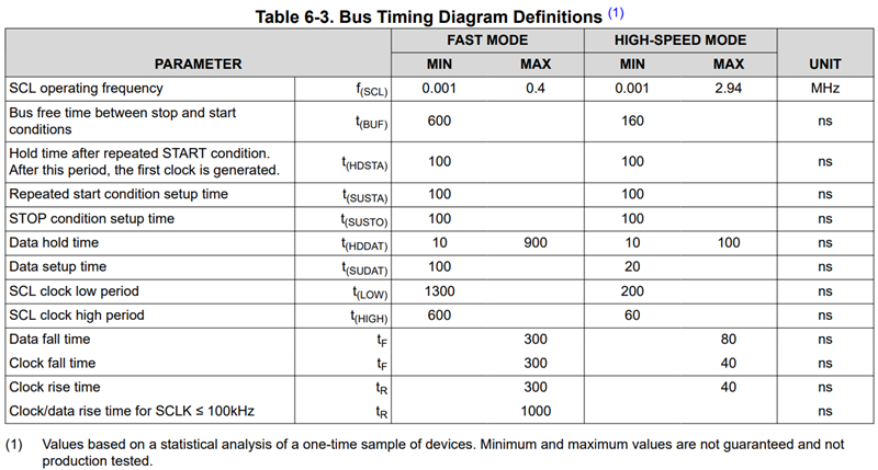

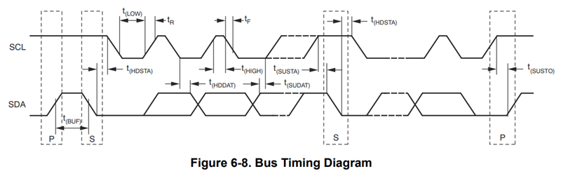

  • Hello Santhosh,
    It's hard to say for sure, but it looks like you may be having some I2C timing issues. From this timing diagram:
    It looks like your t_HDDAT might be too small, as it looks like your clock and data transition at the same time. Try adjusting this timing and see if that works.
    If that does not solve the issue, then I recommend checking the other timing requirements to make sure you are within spec. Similarly, it would be good to confirm the logic levels (especially logic low levels) to make sure that data is being communicated properly.
    Also, when connecting the MCU to the INA226, make sure that the GNDs are shared also.
