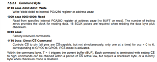

    I think your read and write commands for PGA280 are incorrect, looking at the datasheet in section 7.5:
    For write, assuming the buffer is not used:
    in binary: 0100 aaaa dddd dddd
    in hex: 0x4 (register) (data byte)
    For read,
    in binary: 1000 aaaa 0000 0000
    in hex: 0x8 (register) (number of clks)
    Therefore, the following is not correct:
    // PGA280 SPI commands #define PGA280_READ_CMD 0x01 #define PGA280_WRITE_CMD 0x00
    Try those things and let me know if something improves.
