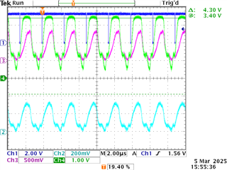

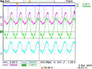

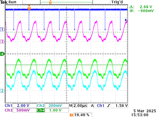

Simulation (in LTSpice, sorry) of my VCA824-based circuit showed DC offset that increases with gain. I think that's the model trying to represent the input offset chip-chip variation. I thought I could live with the worst case offset, but it turned out to be so much worse when I breadboarded the circuit. Unless I can remove the offset somehow, I can't use this circuit.
examples attached. In these, the input to the VCA824 is the cyan trace, and the output is the green trace.
Vg = 115 mV results in this:
Vg = -0.512V
Vg = 0.512V

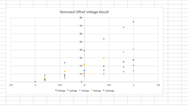

      Thank you for the detailed explanation! Quick question on one point: when you mentioned DC offset that increases with gain, are you seeing DC offset changes with varying gain control? If you are measuring offset voltage at the output of the VCA824, this will change with gain due to being gained up depending on VG set.
      I recently looked into VCA824 output voltage vs Vg. I was able to measure offset voltage by measuring the output vs Vg at 0V input voltage. With this data, I removed this value to any of the other input voltages vs Vg. Below is data I took in the lab at DC input voltages.
    Sima

  • Most emphatically YES, I am seeing increased offset with addition of gain. The green trace in the scope shots I included is the output of the VCA824 at three different values of Vg. Input is the same (cyan trace) in all three.

  • Hi Sima
    2nd question first: input is near 0V - there might be a small offset. DC values can be determined from the cursor values ...oh wait, no it can't, I failed to adjust the cursors, sorry. Top trace offset is ~-900mV, middle trace offset is ~-2.0V, lowest trace offset is ~+80mV.
