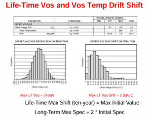

My customer has the following question.
After 10 years operation, Vos would meet still within datasheet spec?

Hi Hirano,
Vos in op amp will change over time. Values are expected to change approximately double of initial Vos_max specification, see the attached link.
https://www.ti.com/lit/ml/slap177/slap177.pdf
