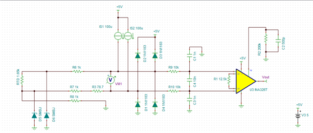

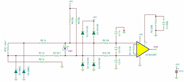

Hello Manohar,
Thank you for providing the screen captures of the simulations.
I noticed for INA326 simulation, you have a * on your RTD, what is the range of values on the RTD?
Could you please provide your .tsc? What type of sweep is being performed? DC, AC, transient?

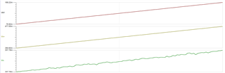

Hello Manohar,
Thank you for the additional information, .tsc stands for the TINA file. I built a version on my end & received weird results, see attached: 3326.rtd.TSC
If we consider the input from the RTD:
RTD Range (Ω) | 846 | 1770 |
VM1 | 76.8m | 169.22m |
VIN+ | 384m | 477m |
VIN- | 307m | 307m |
VCM | 345.6m | 391.61m |
Vdiff | ±38.4m | ±84.61m |
Vout ideal (G=23) | ±883.2m | ±1.946V |
RTD range 846 to 1770 ohms, results in VCM range of 345.6mV to 391.61mV with Vdiff of ±38.4mV to ±84.61mV.
Considering the power supply in both of the schematics above, this will not work as the amplifiers cannot output below the negative rail.
What power supplies do you have in your system?

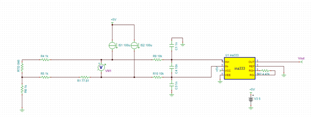

Hello Manohar,

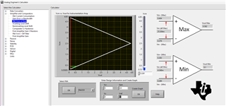

Please see the VCM vs VOUT plot for the INA333 with the configuration you have provided.
With a 5V, single supply, gain of 23, and a common-mode voltage of ~350mV to ~390mV, your valid output range will not exceed 600mV. Your max input voltage differential that can linearly be output is 25.3mV.
Generally the input common-mode range should be above the V- rail to avoid saturating the internal nodes of the instrumentation amplifier.
I'm not sure that the INA333 is a good fit for this application. You may want to look into a 2-amp INA with VCM near V-, like the INA122. Please note that the VCM vs VOUT plot in the analog engineer's calculator tool is incorrect for the INA122.
For additional resources to understand this behavior, please see the following TI Precision Labs Video: https://www.ti.com/video/6216438746001
