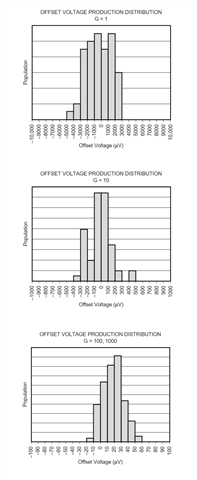

    Correct, with the gain you provided, you can expect offset around 12mV and up to 60mV. I assume that for the application note, the DC offset was assumed to be calibrated, and this just leaves input offset drift of 0.1uV/degC, as well as any effects due to bias current. However, the application note equalizes the input impedance seen by each instrumentation amp input to cancel out bias current effects.

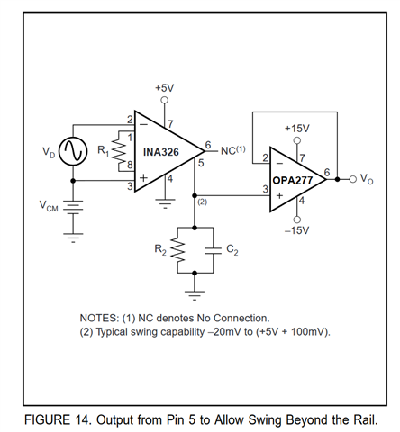

    This offset will be random on the onset of the usage of the device (i've provided the histograms for the offset voltage RTI across multiple gains). Generally for split supply circuits, both inputs can be grounded, then the difference between GND and output is measured to be the offset, and this is subtracted out in software by the microcontroller. It becomes slightly more challenging in single supply, as you will not be able to ground both inputs with a grounded reference voltage, since you will be outside the voltage range of the output amplifier.
    If you are able to sense off of pin5, this pin can go up to 20mV below V-. In this case, for the majority of the offset voltage cases, you may zero both inputs, and you will see just the offset voltage on pin5. This allows you to not worry about the output swing from rail limit of the buffer amplifier. The example for this is shown on figure 14 of applications circuit.
