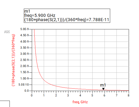

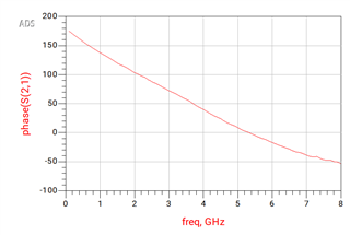

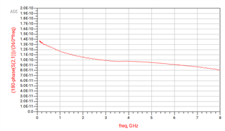

    Thanks for your question. The most accurate model for the time delay is going to be the S-parameters, as these are measured. The spice model is going to be a fitted approximation of device performance. I have plotted the phase of the power gain from the input to the output, and you can see there is a 180 degree phase shift at low frequency, which looks like an inversion in the time domain.
    You can take the phase to a time delay by dividing the unwrapped phase value in radians by 2*pi*f. Plotted, this gives the following:
    Looks like there is between 140 pS and 80 pS of delay.
    Let me know if any more questions come up,
    Gideon

    (2) The phase characteristics show a phase shift of 180° in the low frequency range.
    I understand that at this time, the operation is like inversion.
    (3) As the frequency increases, the phase shift decreases, and at 5.3GHz the phase shift is 0°.
    Is it correct to understand that at this time, the input and output phases are the same (non-inversion)?
    (3) Furthermore, at a frequency of 6GHz, the phase advances by about 20°.
    Should we consider the phase delay to be 340° when using a single pulse?
    In that case, the delay time is 340/(360×6G)=157ps. Is this correct?

  • Hi there Shinichi,
    1. I was just working with the S-parameters. The spice model is a fitted behavioural model, and so to guarantee performance I was using the S-parameters, which are measured.
    2. Yes that is correct, at low frequency, there is a 180 degree phase shift, which looks like an inversion.
    3. Yes that is correct.
    4. Yes good point, since TI has yet to build a non-causal IC haha. So at a phase advance of 20 degrees, then the delay can be thought of as 340 degrees, which at 6 GHz, corresponds to 157 pS. But after you account for the inversion (add 180, not 360), this corresponds to roughly 74 pS. I was incorrect in my original plot, it looks like I subtracted 180 instead of added. The corrected plot is below. Note that I add 180 not 360 because I am accounting for the inversion.

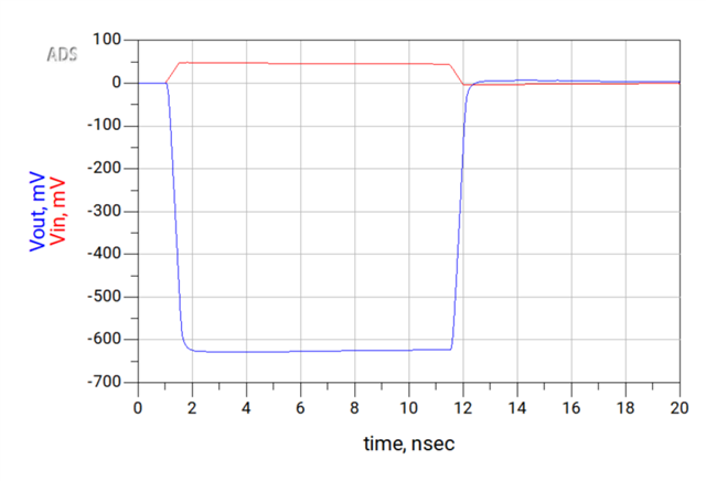

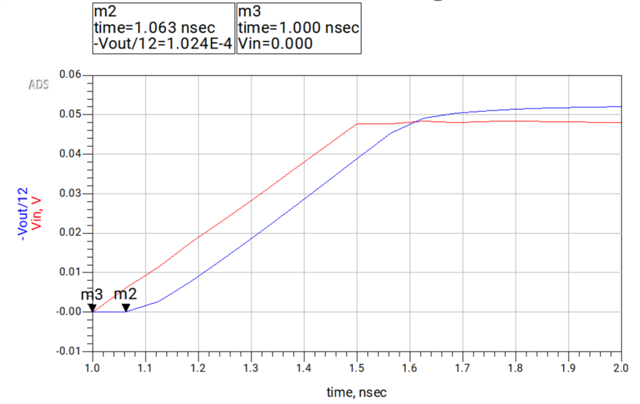

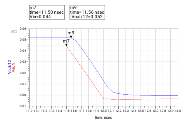

    I also added a pulse input to see the response. The time domain plot is shown below:
    The red curve is the input, and the blue curve is the output. Zoomed in and scaled is on the right. As you can see there is about a 63 pS delay, which more or less matches with our frequency domain plot.
    Gideon
