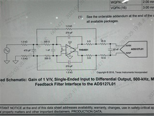

However, for a differential MFB circuit like the picture shown below, how should the cutoff frequency be calculated? Could you provide the calculation formula?

    I can support this request for you.  For balanced (or differential) filters the math is mostly the same.  The difference between single-ended and differential filters is with the passive components which have ground (GND) nets in the calculator tool for single-ended.
    For the 470pF capacitor in the THS4551 example in your reply, this capacitor is 1/2 of the value calculated by the single-ended design (940pF).  This is because two equal-value capacitors in series are equivalent to one capacitor with half the value (like parallel resistors).
    The value for Cf (270pF), Rf (1.2kOhm) and Rg (1.2kOhm) remain the same for single-ended or differential.  You need only replicate the feedback and gain resistors for the other side of the FDA.  The 330 Ohm input resistor also keeps the same value; this resistor is R2 in your shared example website calculator.

          Thank you for solving my confusion! I have another question: how does the 1nF capacitor in the example affect the cutoff frequency? Can it be treated as an RC filter circuit composed of a 330Ω resistor and a 2nF capacitor when calculating the cutoff frequency?

    The 1nF capacitor in parallel at the two input nodes is not for the active filter.  This capacitor is often drawn or shown in EVMs or datasheets, but can be left DNP (do not populate) for most designs.  This input capacitor helps provide additional stability if the FDA circuit needs to compensate for instability caused by the feedback network or load.
    For the design we are discussing, this 1nF capacitor would be considered an 'extra feature' that would only be used (put onto the board) if needed.  Many EVM boards or designs will either not place this capacitor (DNP or leave unsoldered) or remove it from the design.
    Your MFB filter consideration is okay with only Rg, Rf, Rinput, Cinput, Cf as we discussed above.
