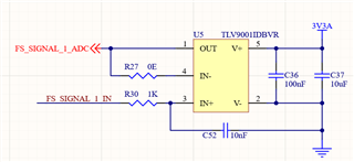

Hi, We are reading a signal from sensor in the field, the signal is varying from 2 - 0V dynamically. the scope is to measure amplitude and its frequency which was done. The microcontroller is able to read the amplitude and frequency but near 0 voltage(approx 50 - 100mV) if there is any oscillation the controller couldn't read it properly. The sensor signal is fed to unity gain amplifier and its output is connected to controller. We are thinking of adding 500mV offset to the signal so when the signal vary from 2-0V we will get 2.5-0.5V. we don't want to add this offset before amplifier just to avoid impact the impedance of signal. Offset at the output will be a best option. current schematic of amplifier stage
what is the best way to achieve it ?

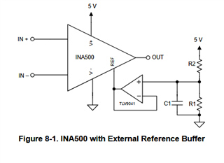

  • This circuit already loads the input signal with the low-pass filter. Use 10 kΩ and 1 nF to reduce the load. Use three more 10 kΩ resistors for a difference amplifier. If you care about precision, use an integrated difference amplifier like the INA500.
    Do you already have the 0.5 V reference voltage? If you generate it with a resistor divider, you might need to buffer it with another opamp.
  • Thanks for the inputs !!
    We are going for next version of Hardware so we have freedom to change/update the circuit. After your input we went on a search for differential amplifier and its designs. this example from INA500 datasheet matches exactly

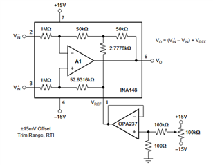

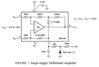

    We also found another example with INA148 which has same configuration and output but with feedback from output and reference tied to output.
    In our case we will connect the -ve input to GND and positive to Signal Input. the difference will always between 0V-Signal Voltage. May we know which one suits best for our application?
  • Both the INA500 and INA148 would work, as would many others. The INA148 has a more complex feedback network to allow a wider common-mode range, but this does not matter for you.

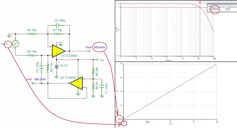

  • Below please find a discrete implementation of the circuit you describe using dual TLV9002 - see below.
    Below I have attached Tina-TI schematic for your convenience.
    Tylor TLV9002 difference amplifier G=1.TSC

  • INA148, like OPA146 and INA149, is a high voltage difference amplifier meant to be used for very high input common-mode voltage range of up to +/-200V and for this reason it's higher price whereas what I believe you need is 3.3V single supply diff amp with input common-mode voltage within the supplies and Vin_diff from 0 to 2V.  For this reasons, a very inexpensive low voltage INA500A is a better choice.  One thing you need to be aware, however, that since output is a function of Vref, in order to measure Vin_diff input signal down to zero, you must lift the output to al least 50mV to 100mV so your microcontroller can read by applying said voltage to reference pin:: Vout = Vref + Vin_diff*Gain = 100mV + 0*1 = 100mV
    Also, please note that the maximum input voltage offset of INA500A is +/-3/5mV - see below.
