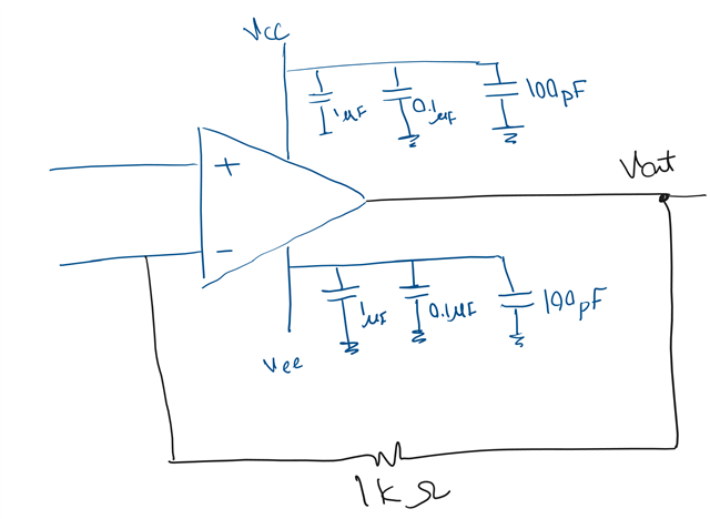

  • Dear Ignacio,
    Thanks for your reply.
    Today I tested the opamp in a simple biased circuit, as shown below:
    I'm seeing the output with oscilloscope,
    In dual supply mode (-7.5 and +7.5V):
    at the oscilloscope I'm seeing a signal at 135MHz, with 83mV peak to peak and 17mW power.
    in single supply mode (0,15V):
    at the oscilloscope, I see a noise-like signal, starting from 130mW power and going down to -3mW, having a peak to peak of 3mV.
    In both cases it heats up, I am using SOT-23 packaging, do you think changing the packaging to the bigger one would help?
    Thank you so much for your help,
    Mahsa
  • Hi Mahsa,
    The package should not be an issue and simply turning on the device without an input signal should not cause the device to heat up and oscillate. Could you share the PCB you are using. This is a very fast device and PCB layout is critical.
    Ignacio

  • Hi Mahsa,
    Assuming the circuit was configured correctly like the circuit in the datasheet, I would say the issue is the breadboard. We see oscillations when breadboarding devices in the 200MHz range, a device in the GHz range will almost certainly oscillate. I would like to add that this device is not recommended for new designs, and we typically recommend the THS3491 as an alternative. As far as guidelines, there are some in the datasheet of the device starting on page 19. There is also a layout example later in the same section. For high-speed devices, one of the most important layout recommendations is to cut the planes under the inverting input pin and output pin. The layout in the datasheet highlights this. Short traces along with proper decoupling close to the board should also be implemented. We do sell an evaluation board for the THS3491 as well, which could be a good option for quick testing. I attached the EVM for that board below. It is a great resource for seeing how to layout your PCB.
