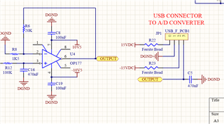

  • X_OLCC_1V1.pdfX_OLCB_1V0.pdf
    Dear Raymond,
    I have put 2 schematics. some parts are not populated like ADR435, AD5611, AD7391. On both boards I am adjusting reference pin on ad620 with a POT R9 and R16 on different boards.
    How can I measure parasitic capacitance of my cable. This is not the first time I am using OPA4180 on a machine. Until now I have used 150 boards with OPA4180. In different machines of course. Some have similar cable lengths some shorter. I have not experience this much of ripple on output in any other machine before but some how from the first board until now I was not happy about OPA4180 because even it is very hard to detect difference because of low voltage levels I was noticing weird oscillation with very low frequency like couple of minutes. But oscilations were reasonable on test setup or on some boards nothing weird happens. And there not much a ripple on the output. On this machine output has huge ripples and it swings. I am going to test different cable lengths and board to further investigate the root of the problem.
    Is 100 ohm effect drift characteristic of the board. Do I need to use low temp coefficient resistor on this.
    Abour power sequence what can I do about it? Why OP177 does not have such a problem but OPA4180 has. While I am testing boards I noticed this. normally you do not plug and un plug boards on the machine. But I suspect that in regular operation without touching connector. Can output saturate or not when the power is switched on.This is nightmare for me.

    You can use LCR meter to measure the parasitic capacitance of you cable. Typically, a quality audio cable will specify the pF/foot and indicate the parasitic capacitance in their product.
    The issues you encountered are op amp loop stability issues, where different op amp needs to compensate the Rload and Cload differently depending on the op amp's characteristics, such as open loop output impedance, op amp's BW and phase margin etc.. Here is some information about the loop stability issues in op amps.

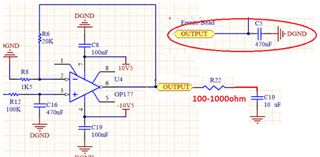

  • For more than 10 years I have been using OP177 with following schematic at the output.
    This C5 capacitor is 470nF. Once I switch from OP177 to OPA4180 I have noticed the oscillations. And previously I was offered to remove C5. Which it solved the issue back then. But it was on my test setup.
    do you think transition from DIP to SMD packages have some effect? OP177 that I use was dip package.
    No op amp is able to drive large capacitive load direction. 470nF is a large capacitive load;  OPA177 is unable to drive it directly. It is possible that you did not observe the oscillation while using OPA177, but OPA4180 did. An op amp is required to be compensated if it is driving a large capacitive load,. Please let me know which op amp you are going to use and I will performance loop stability analysis and try to compensate an op amp and improve its phase margin.

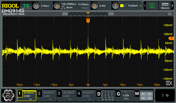

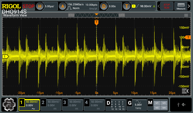

  • Hello Raymond,
    I have checked system with a scope. Both systems. The test setup and machine the only difference that I found is voltage supply to amplifier board has more switching noise on the machine.
    This switching noise is couples to analog output pin because both supply voltages and analog output signal is carried with the same USB cable. This picture below is output of OP4180.
    Maybe this is the reason why on test setup I do not see that much problem but on machine boards perform worse. Also I have added 390Ohm. But with scope I can not see difference between the board with 390 ohm isolation resistor and the one that has not. But in PLC analog input module I can see difference.

  • Hi Dogan,
    Yes, the scope shots indicates the switching frequency is not properly attenuated by the LC low pass filter, where I see 200kHz to 500kHz switching frequency in your DC supply rails. The op amp's PSRR does not attenuate such high frequency effectively.
    Below is OPA177's PSRR plot.
    "OPA177 is capable to source more current than OPA4180"
    The Isc or short circuit current indicates the max. current an op amp is able to source. OPA177 is able to source/sink up to +/-35mA.
    OPA4180's Isc is only about +/-18mA.
    Typically, up to 60-70% of Isc is usable depending on the Tamb operating temperature. And the power supply's ripple requirements for precision op amp application is typically <+/-1mVpp. For general purpose op amps, <+/-10mA may be acceptable. We are talking about low noise frequency, where PSRR is able to attenuate it.

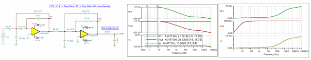

    I have created a TINA sheet to analyze my filter. I used analog devices filter design tool to create a filter. Can you help me on how to check phase margin, step response and noise analysis.
    LC_amp_1.TSC

    In the filter stage, you had typo by reversing the -/+ supply rails in OPA202. The gain of the 6h order Sallenkey filter is approx. 12.12V/V. The Sallenkey has a characteristic hump or rising gain after the loop gain is running out. I added a LPF at the end of filters to minimize the total noise of the circuit.
    OPA202 6th orther Bessel Filter 07162025.TSC
    You may be better off to use 2X MFB + RC LPF filter to attenuate high frequency noise. Yes, you have achieved -120dB/decade effect after the cutoff frequency, but filter may also add unnecessary noise to the system.
    I did a quick one and you can try something like the circuit below - same effects - op amp.
    OPA202 4th MFB Filter 07162025.TSC
