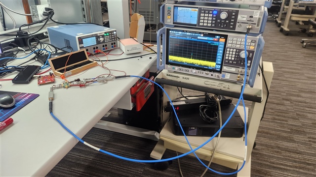

    Without knowing how the board is set up, its hard to say what exactly could be causing this deterioration. It could be that the HD2 from the spectrum analyzer is causing some issues. I was initially facing this issue, and i can share what i did to get around it.
    Pictured below is my setup:
    I have SMA100B going through 800 MHz LPF into LMH3401EVM with INM terminated through a DC block. The OUTP and OUTM go into DC blocks, 3 dB pad then into a balun, then finally into the spectrum analyzer. There is also resistors on board to aide in matching, which add another 3 dB of loss. Total loss at the output of the device is around 11.1 dB. This means that for a power of -3 dBm out of the device, i was looking for -14.1 dBm at the spectrum analyzer.
    The spectrum analyzer required internal RF input attenuation to be increased to 31 dB to ensure its HD2 was below the DUT. I think this could be the issue you are facing. As for why the measurement was better without the LPF vs with, it could be due to some phase adding constructively/destructively from the signal generator artificially lowering the number.
    Here are my HD2 measurements, I had to zoom into very close around the fundamental for this to keep the sweep time low: Fundamental is on the right and HD2 is on the left.
    As you can see, I am seeing about 66 dBc of HD2 at this frequency.
    Let me know if theres anything else i can help with,
    Gideon
