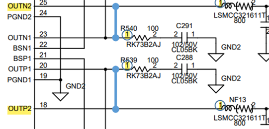

We are currently evaluating a board using the TPA3112D1, but we have mistakenly manufactured the PCB without connecting the output paths (highlighted in blue in the attached schematic) from the OUTP/OUTN pins to the speaker.
Specifically, the ferrite bead + capacitor + speaker network was intended, but the jumper connecting OUTP/OUTN to the filter and speaker is missing, so the amplifier outputs are essentially floating with no load connected.

  • Hey Conor,
    I strongly advise following the typical mono application schematic for this IC. The behavior of the device if breaking DS guidance is unpredictable and not something that can be supported. You could try air wiring your connection and observing the audio output.
