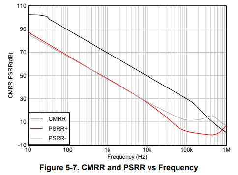

  • Hi Raymond,
    I apologize, but it was not an audio signal.
    I use it to detect piezo waveforms.
    It is not audible as sound, but occurs as input noise to the ADC.
    The specific noise is as follows.
    Frequency: Approximately 36 kHz
    Amplitude: Approximately +/-25 mV
    It also appears to be affected by power supply noise originating from the MCU, and we are considering various countermeasures.
    Please let us know if you have any useful countermeasure methods.
    Ryu.
  • Hi Ryu,
    I see. Based on the PSRR plot in the datasheet, the TLV9144 has a reasonable PSRR at lower frequency. The part is meant to be used in battery powered device.
    Here is what you can try. At the V+ supply rail (assume you are using single supply rail), please add 100ohm resistor + 16uF to 22uF capacitor to form a LPF filter. With 100ohm/22uF, it will have a cutoff frequency approx. 72Hz (use Tantalum capacitor or low ESR electrolytic capacitors). This will improve the PSRR rejection significantly and will not be significantly affected CMU.
    In addition, in the CMU's power rail, use larger low ESR bypass capacitor, up to 10uF or 22uF and this will get rid of noise generated by MCU (say PWM or other square wave related noises. Pay attention to DC bias derating in capacitors, if small C package is used.).
    You may also consider to use ferrite bead next to the power rail of MCU, but you need to make sure that the voltage rail is properly dampened with capacitors to avoid Q effects.
