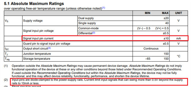

Hi Eddie,
Customer would like to know what is the maximum forward current of protection diode.
The max. current to the input pin is limited to +/-10mA, see the abs. max. ratings. The antiparallel ESD Diode topology in front of OPA928 is to minimize the diodes' leakage current.
If you have other questions, please let me know.
Raymond
