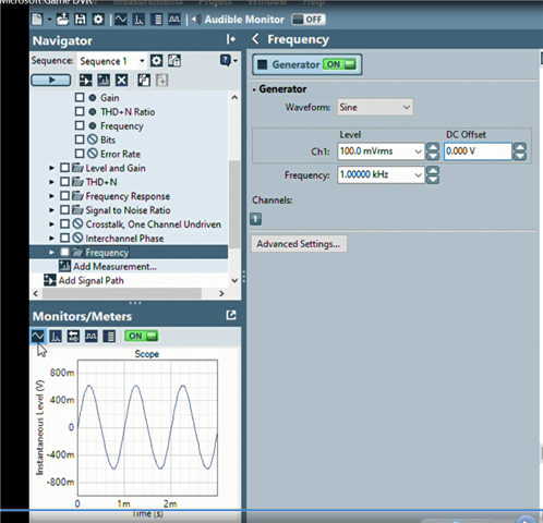

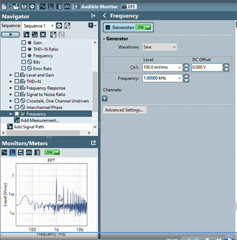

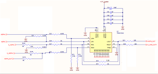

We are using TPA6120A2 in our design, when we are giving sine wave (1KHz, 100mVrms) input to TPA6120A2 at HDPN+ and HDPN-  from the analyzer and observed that there are harmonics at output signal name is HDPN_OUT. the FFT signals and scope signals attached in images these signals are captured at HDPN_OUT.   the Schematic diagram i have copied in the attachement for your reference. Please ignore RIN+ and RIN- circuit as its not used at present. only consider LIN+ (HDPN+), LIN- (HDPN-) and LOUT (HDPN_OUT).
