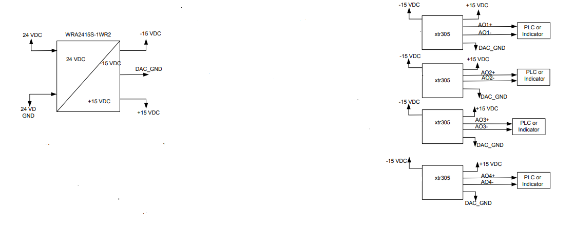

I am using XTR305 in my design for output 4-20mA or 0-10V.I want to use 4 XTR305 in my design.Can i know how much current will -15v and +15v will consume.So that i can able to choose powere supply module.

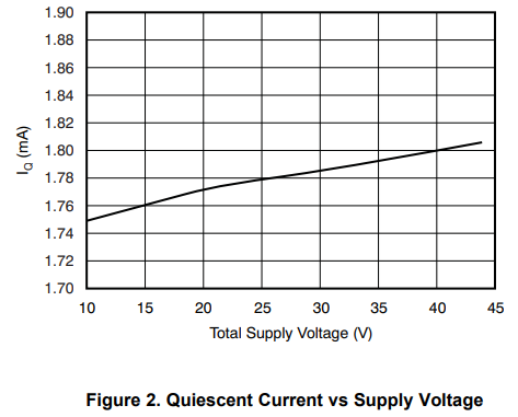

Quiescent current vs total supply voltage graph is in Figure 2:

Hi Sreekar,
Is the input voltage +/-15V or the supply voltage rails? And if you do not need bi-directional current or voltage output, I recommend using the XTR200. This device also has less current consumption if that is a concern.

Thank you for the additional information of the design. Based on the schematic drawing it appears you are drawing a 4-wire transmitter design with the two outputs. The XTR300 is meant for 3-wire transmitters and cannot be used for 4-wire transmitter designs.
Please see the blog and FAQ links here on how to design for 4-wire:
