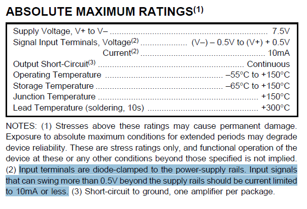

in an old datasheet of the OPA354 there is the following phrase in the maximum ratings:
"Input terminals are diode-clamped to the power-supply rails. Input signals
that can swing more than 0.5V beyond the supply rails should be current limited
to 10mA or less."

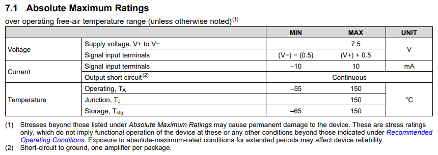

In the new version however, this cannot be found anymore.
My question:
Does this still apply to todays OPA354 and can I safely operate it the following way without it getting damaged over time?
V+: 3.3 V
V-: 0 V
V_in: +400 mV / - 200 mV
I_in: ~ +/- 100 uA
